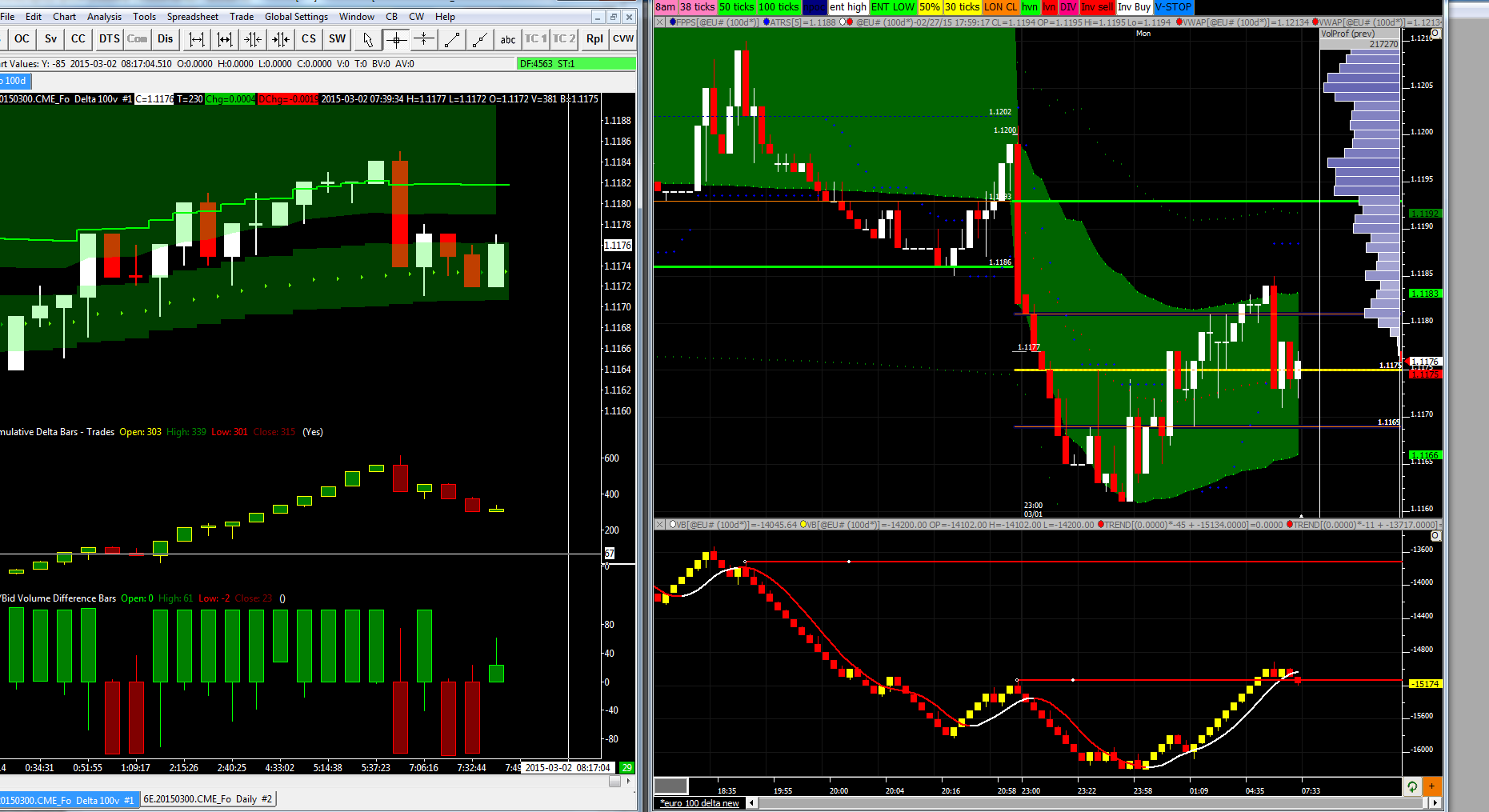

I have a 100 delta main chart. I then added a cumulative delta study below it. I expected all the delta bars inn the study to be the same size i.e 100 delta blocks but they are not. I have this chart set up in Market Delta and all the blocks are the same size.
Can you tell me what is wrong?

[2015-03-02 07:47:40]
User711883 - Posts: 7
Thank you for the info. It seems to have improved the chart but it is still not the same. I have put a side by side screenshot to show you the difference between the market delta chart and Sierra chart. I can use historical cumulative delta levels in MD re: the red lines attached to significant pivots in the delta. This is not obvious in the Sierra chart.
I would like to get 100 delta blocks showing in the Sierra chart as it is in the MD chart.
I also added the BV vs AV underneath it shows delta correctly but in a straight line and not cumulatively which is what I want.
Hope you can help.
image100 delta (2).png / V - Attached On 2015-03-02 07:46:36 UTC - Size: 141.39 KB - 732 views

[2015-03-04 12:04:49]
I have found my mistake. I was using cumulative delta in trades and not volume.
I now have the charts looking the same.
Thank you for your help
