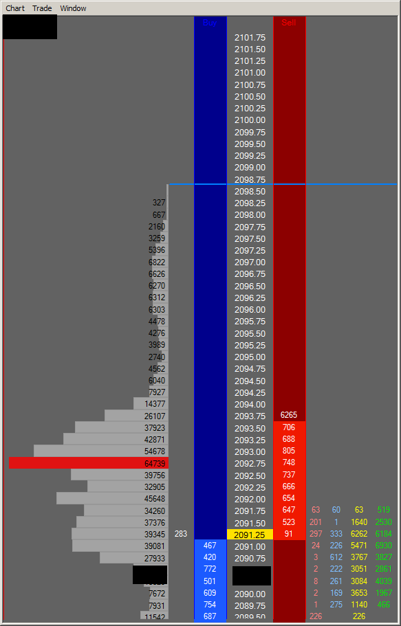

[2015-02-18 19:09:00]
joshtrader - Posts: 569
This is not the problem -- what's actually the problem has to do with the graphics drawing it seems. For example, see the two attached pictures. I scrolled up and down a bit, and when the bottom tick of the profile goes out of view, the numbers show. If it is in view, they do not. The VbP is the only study on this DOM. I could not reproduce this with a VbP on a regular chart (could not get the numbers to show either way).
Also note that OCO order connecting lines were hidden when the top order was off the DOM view, and when I scrolled higher, the lines reappeared once the order came into view.
Date Time Of Last Edit: 2015-02-18 19:10:52
image1.png / V - Attached On 2015-02-18 19:08:48 UTC - Size: 51.66 KB - 561 views
image2.png / V - Attached On 2015-02-18 19:08:52 UTC - Size: 64.02 KB - 460 views
