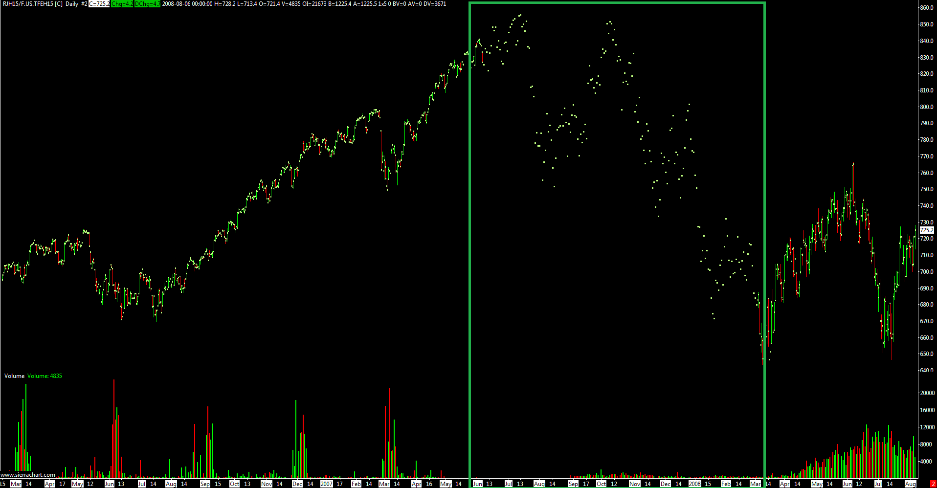

Hello SC team, could you please check if the historical data are correct for the symbol? Please see screenshot attached. Looks like data for some contracts are missing. Thanks.

Follow the instructions here to re-download the data:
https://www.sierrachart.com/index.php?page=doc/doc_ContinuousFuturesContractCharts.html#ReDownloading

I have already done that and have even deleted those .dly files for the symbol but results are the same.

We did not realize you were looking back so far. We cannot help with data that far back for this particular market.

We think the problem is the Russell was trading at a different exchange at that time and had a different symbol.

Yes, you are right. It had been exclusively traded for 3 years on CME before it moved to NYBOT in Sep 2008. So, is it a "natural" gap caused by changing exchanges then?

It relates to it, the problem is I am not sure how that data can be corrected being it is so old because I am not sure there is replacement data our data provider can get access to, to correct it.
In order for us to know what particular contract month that is, enable Chart >> Show Rollover Dates. And post an image again.
