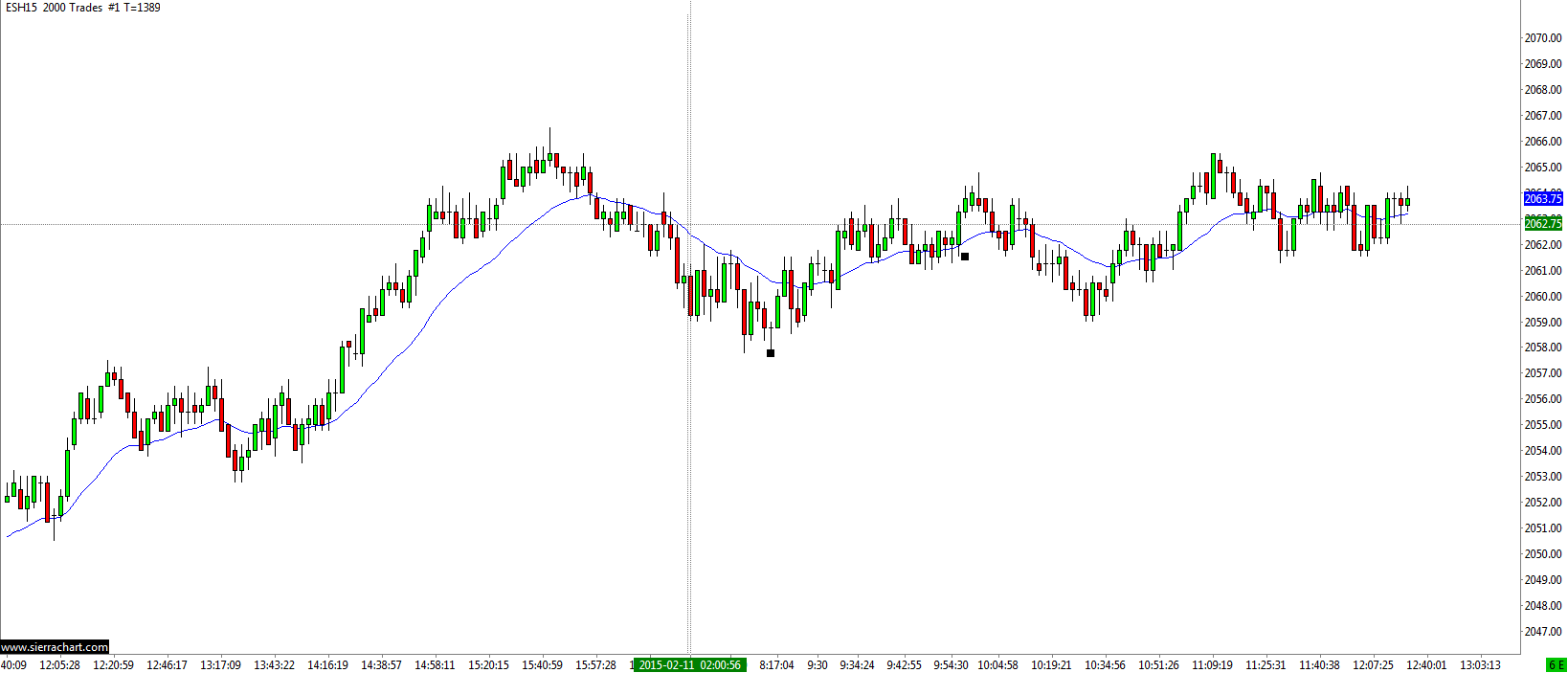

[2015-02-09 23:19:29]
User836021 - Posts: 6
The pencil is activated but when left click and hold to start a line nothing is visual. When I release the mouse at the desired position nothing is shown. The pencil is still activated until I hit the left button once again and then the start and finish spots are shown with black squares. I have made sure that the Tool config. is set up for a visual, black lines on a white background.

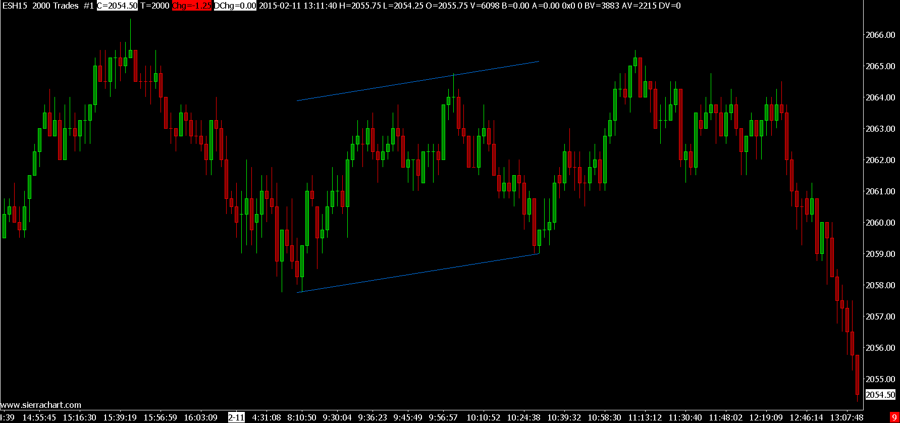

[2015-02-11 16:56:58]
Post an image of the chart you are drawing the Parallel Lines on, so we can better understand why there might be a problem.
[2015-02-11 17:51:11]
http://www.sierrachart.com/image.php?l=1423677049361.png
[2015-02-13 04:30:27]
Do you notice a problem with the Parallel Lines tool with another symbol?
We have tested the drawing tool in the identical chart set up and it works properly:
http://www.sierrachart.com/image.php?l=1423802005952.png
