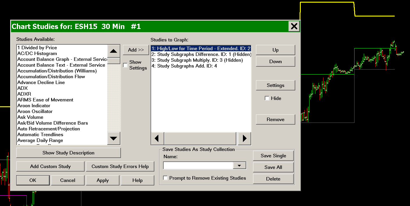

[2015-02-24 04:41:17]
The first step is to write out step-by-step the method of calculation and then you use a combination of the Study Subgraph(s) Arithmetic studies to arrive at that calculation.
All of the Arithmetic studies that are used for intermediate calculations but are not needed to be displayed, need to be Hidden.
We have attached an image of the studies that you would use in this example.
Date Time Of Last Edit: 2015-02-24 04:41:39
imageStudySubgraphsArithmeticStudiesChannelExample.png / V - Attached On 2015-02-24 04:41:09 UTC - Size: 23.53 KB - 524 views
