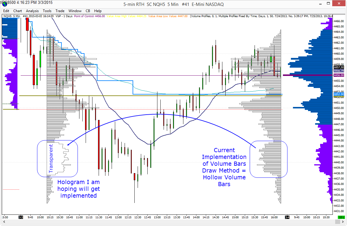

Thanks for many of the changes that are being implemented by SC. I just wanted to provide a clarification on item #2 (Hologram). I am hoping you have not completed the implementation of this feature. The attached picture shows a partial picture of a hologram I was thinking about.
Thanks.
imageHologram.png / V - Attached On 2015-03-03 21:31:57 UTC - Size: 63.76 KB - 849 views
