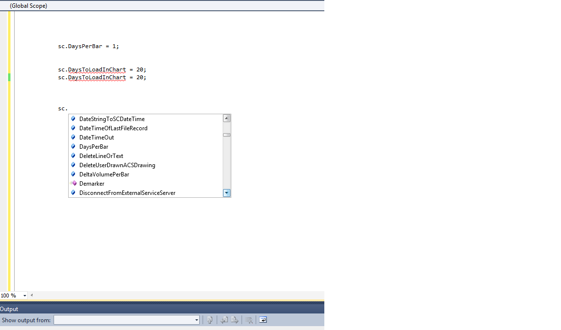

Yes, thank you, sc.DaysToLoadInChart is exactly what I need but when I try to code it, I get the error message; Error class "s_sc" had no member DaysToLoadInChart"
It does not show up in the drop down list of sc.xxx
Just to check I wasn't doing something obviously wrong, I tried the member prior to sc.DaysToLoadInChart on the page you sent; sc.DaysPerBar, and that does work and does show up in the drop down list.

Thank you, but does not work
I am programming in Microsoft Visual C++ 2010 Express, and it does not recognize sc.DaysToLoadInChart so I get the squigly line under it to indicate the program does not recognize it.
Also, if I type sc. into the program, it gives me a drop down of members associated with sc. and sc.DaysToLoadInChart is not there.
Are you able to replicate that drop down with members?

Zosimus - Posts: 345
I am using VC++ 2010 too (not express though) and I do get the sc.DaysToLoadInChart in the drop down when I type sc.
I am attaching here the properties template file that I use for myu SC projects. perhaps it could help you find what is wrong.
You might want to pay attention to the settings under General, C/C++ and Linker.

Trade Nice - Posts: 75
Thank you ejtrader and yon.
I replaced the version of ACS_Source I was using with the latest version, and sc.DaysToLoadInChart now works.

[2015-01-24 08:38:23]
sc.DaysToLoadInChart was added in version 1216 . Therefore, the problem is the version of Sierra Chart you running is older. Update Sierra Chart.
