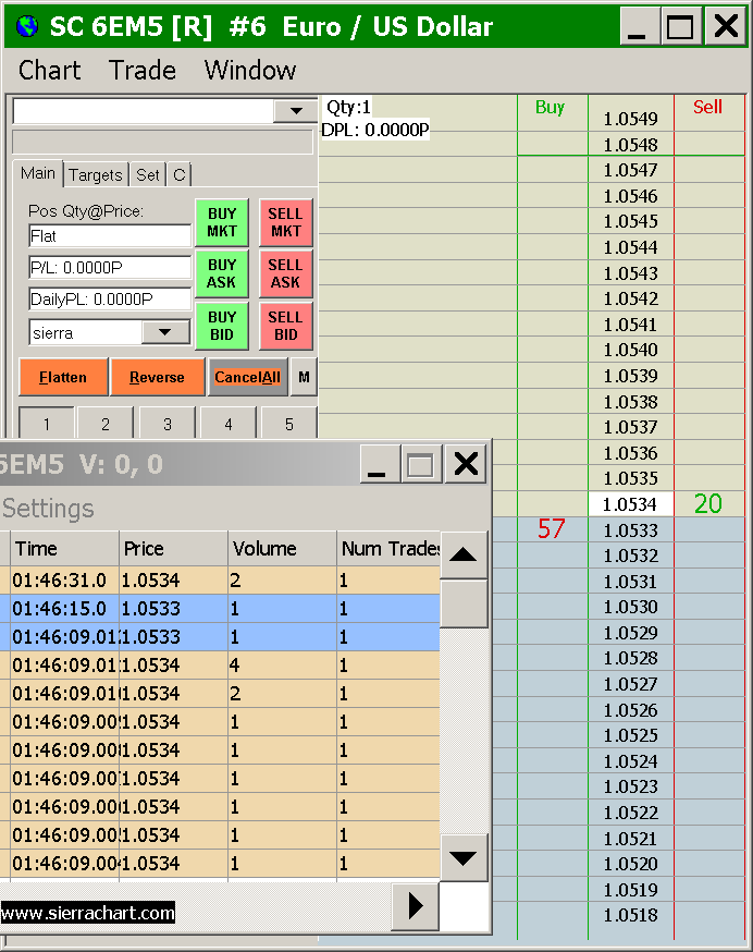

>>The Time and Sales window for a Trading DOM works for us when using remote data:
http://www.sierrachart.com/image.php?l=1426484821648.png
i believe the 57 and 20 are the inside bid & offer on your attached image, are they not? if so this image is irrelevant and unhelpful. or are these recent fills?
to be clear: on my chartDOM i have columns for both Current and Recent time&sales prints. these are the columns i am expecting to see populate as orders get filled. these fills will print when using broker data but not with DTN data from the source chart.
It is important when communicating to us, that you use the documented terminology and the specific field names you see in the user interface.
Those are never documented as Time and Sales fields.
These fields will not work when using data from a remote instance of Sierra Chart unless Use Non-Chart Data from Remote Instances is disabled. There is no possibility of this. So it took 25 posts to finally understand what it was you were referring to.

Other than the market depth columns, those Chart DOM columns do not work across instances of Sierra Chart.

What you are referring to is not Time and Sales data. That data does transfer across instances of Sierra Chart as we have shown and indicated in the above postings.
What you are referring are more specialized Chart DOM columns like the recent bid and ask volume. These are documented in this section here:
https://www.sierrachart.com/index.php?page=doc/doc_GlobalTradeSettings.html#ChartDOMColumnDescriptions
The ones that do not transfer across instances of Sierra Chart, are indicated that they do not.
