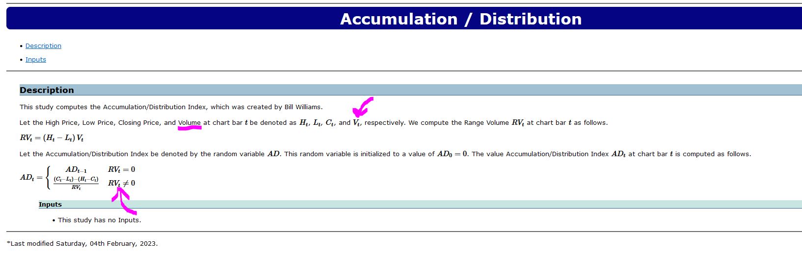

I see that in the "more understandable format" http://www.sierrachart.com/index.php?page=doc/doc_TechnicalStudiesReference.html#s42 you are bringing in the term 'volume'. However in reading about Williams Accum / Dist, he does not use volume in the calculation.
Then reading the Sierra source code, I don't see volume in the code.
Is this Study, using Volume in it's calculation? (hopefully not)
Another question: I'm assuming in this study that the total values from the study are cumulative (add or subtract values along the way to arrive at a constantly changing cumulative value)
Hopefully, this Study does not use Volume and the values are accumulating along the way.

It is consistent with the original Williams' Accumulation/Distribution indicator, as I don't see anything relating to Volume in this code.
Perhaps SC could verify and update the Technical Studies Reference accordingly.

The reason for my post is clarified in the enclosed screen shot from Sierra's site.
In the Sierra image which is referred to, in a post found above, as a "more understandable format" there are mentions of "Volume"
There is also confusion as to what "Williams" we are referring to. There's Bill Williams and Larry Williams. It appears that both Bill and Larry have produced Accumulation / Distribution indicators. I'm specifically interested in Larry Williams' version. Larry's version does not take into account Volume. It's simply a running cumulative value of the candles high vs. close or low vs. close.
I simply wanted to clarify why the 'more understandable format' shows volume but the source code does not. Maybe the reason is due to the confusion between Bill and Larry's indicators.
