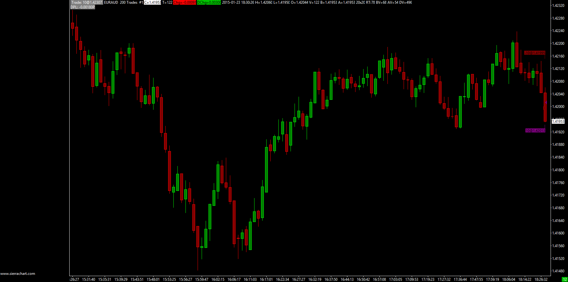

[2015-01-23 18:41:40]
Entropy - Posts: 36
I trade 10 lots, which equals 1 standard lot (100 000 currency units) in LMAX, which means 1 pip equals 10 currency units. The screen shot below shows a trade I made in EUR/AUD. I lost 1.8 pips (-0.00018), but the DPL shows -0.00180, which is wrong.
http://www.sierrachart.com/image.php?l=1422037833313.png
Attached is a similar trade in LMAX Web Trader, which is correct.
I might be wrong, perhaps I haven't understood what you are really measuring with the DPL.
Cheers

[2015-01-23 19:58:39]
You are understanding everything correctly. This was our mistake. We had thought that the task to update the currency value per tick for all Forex pairs for LMAX was done but it has not yet been completed.
We have now updated EUR/AUD. The easiest thing to do is just restart Sierra Chart to get the updated symbol settings.
The other symbols will be updated by Monday morning.

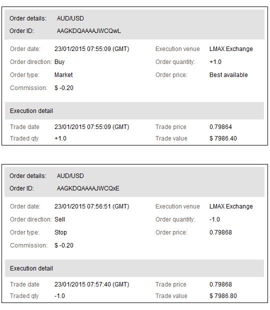

[2015-01-24 09:47:27]
Entropy - Posts: 36
I have been comparing LMAX order data with SC and it seems like there are discrepancies. You state in the documentation that 1 SC lot is equal to 0.1 LMAX lot. Well, looking through the trade confirmations from LMAX, 1 LMAX lot is equal to 10 000 currency units or in other words there is no 0.1 LMAX lot (1000 currency units). 1 LMAX lot is 10 000 currency units (confirmed by the LMAX Web Trader). 10 LMAX lots is 1 standard lot or 100 000 currency units. Perhaps LMAX has changed this recently. In any case you should change it so that 1 SC lot is equal to 1 LMAX lot and so forth.
Attached is a trade confirmation from LMAX. I have used 10 SC lots which shows as 1 LMAX lot. It should be 10 SC lots equals 10 LMAX lots (100 000 currency units). In LMAX Web Trader 1 lot equals 10 000 currency units. I assume it should be the same for the FIX implementation, although I might be wrong. I would be grateful if you could confirm this.
I have a feeling this is related to the issue with the DPL.
Cheers
Date Time Of Last Edit: 2015-01-24 10:26:22
imageLMAXOrderConf.jpg / V - Attached On 2015-01-24 10:20:33 UTC - Size: 45.9 KB - 635 views
[2015-01-24 21:11:03]
Using AUDUSD as an example, what is the smallest number of currency units which can be traded on LMAX?
[2015-01-24 21:39:28]
Entropy - Posts: 36
On the LMAX Web Trader it's 10 000 currency units, which equals 1 LMAX lot. There are no fractional lots on LMAX Web Trader. I can't imagine FIX would be different.
Cheers
[2015-01-25 21:48:28]
What you say does make sense although the problem with this:
Is that if we change this, it would mean therefore that when someone enters a quantity of 10 which they are used to, they are going to end up with 10 times the quantity.
When the interface to LMAX was programmed, we did need to add support for fractional lots. Possibly this was supported back then but not anymore.

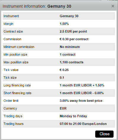

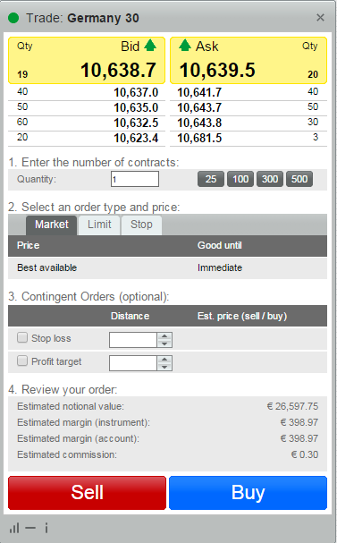

[2015-01-29 11:53:30]
Carl71 - Posts: 125
I am considering LMAX to trade indicies
The German 30 for example has a notional of 1/10 of the eurex future contract
What quantity (lots) I must insert in SC to trade it?
Please see the attached images
Date Time Of Last Edit: 2015-01-29 12:01:31
imageLMAX.png / V - Attached On 2015-01-29 11:53:22 UTC - Size: 26.34 KB - 534 views
imageLMAX2.png / V - Attached On 2015-01-29 12:00:50 UTC - Size: 19.96 KB - 633 views
[2015-01-29 17:46:38]
In Sierra Chart you would enter a quantity of 10 to equal an LMAX quantity of 1.
