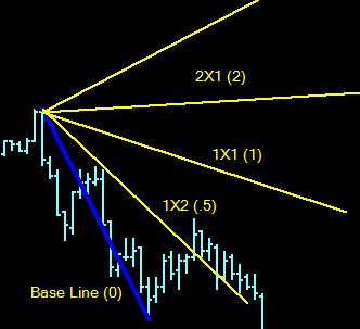

3) Gann Fan base angle: I would like to be able to draw the Gann Fan base to align with a trend line so that the fan lines start from the trend line angle rather than the horizontal as it does now (see attached pic for a hand drawn example).

3. This may not be difficult. Maybe two hours.
