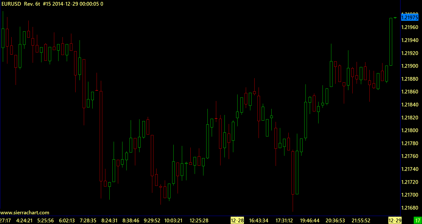

I'm using FXCM data, Intraday Data Storage Time Unit set to 1 tick, but my Forex chart Reversal bars, set to 6 ticks, are not alternating between up/down bars on either my candlestick or Numbers Bars charts. Rather there may be several up bars in a row or several down bars. Can't figure out what I'm doing wrong. Thanks.

Halco - Posts: 92
http://www.sierrachart.com/image.php?l=1419829214212.png
[2014-12-29 06:53:54]
Thinking about this, we see no reason why Reversal bars would alternate between up-and-down bars in regards to the candlestick bodies.
There is nothing in the logic of reversal bars which would cause this to happen.

[2014-12-29 09:39:36]
Halco - Posts: 92
Ok. Glad to know it's working properly then.
Just FYI, your documentation for the Reversal Bars indicates otherwise:
"The Reversal Bar setting is for creating a Reversal bar chart. A chart of this type has alternating up and down bars."
"The first bar will be either an Up bar or Down bar depending upon the direction of prices at the beginning of the chart. After the first bar, the bars will alternate between Up and Down bars."
