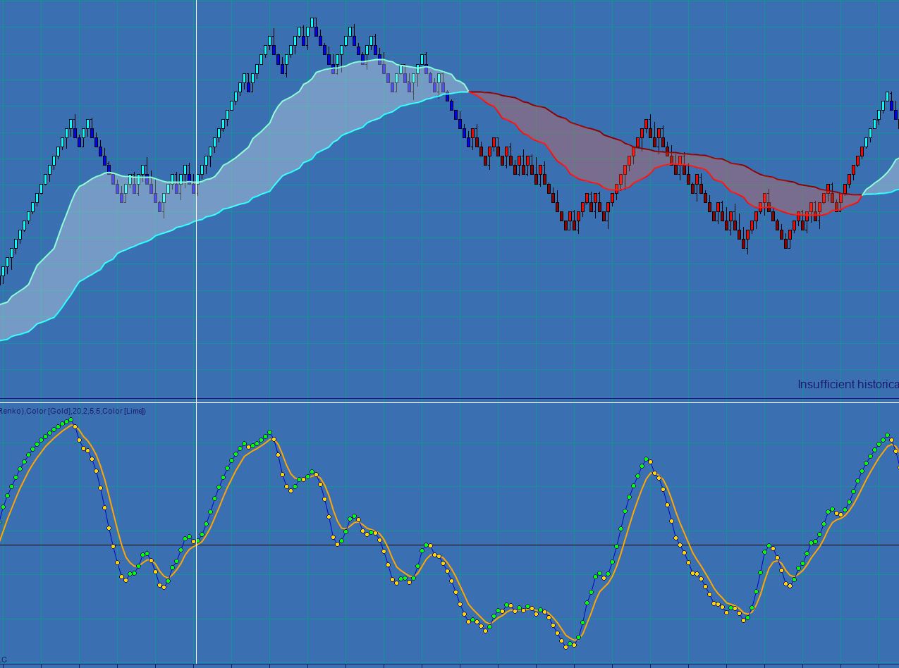

Good evening forum, the attached file is the indicator SMI for Ninja Trader, you can replicate it exactly for Sierra Chart?

imageSMI_Dot.JPG / V - Attached On 2014-12-24 08:31:13 UTC - Size: 127.23 KB - 734 views

Sierra Chart already has a "Stochastic Momentum Indicator" found in Analysis >> Studies.
Documentation:
http://www.sierrachart.com/index.php?page=doc/doc_TechnicalStudiesReference.html#s276
[2014-12-24 20:43:56]
Sawtooth - Posts: 4359
Add a second instance of the SMI study,
-set the Chart Region to the same as the other SMI study
-set the Draw Style of SMI (SG1) to Point
-set the Auto-Coloring to Based on Slope

I saw the indicator of Sierra Chart but mine is different, but little things differently.
I also saw the setting but I do not like, keep my "dot" are different.
Ninja trader as well as set the setting as Sierra also allows another setting graphically more beautiful, you see it in these lines of code.
No offense of course.
if (Falling(smis))
        DrawOnPricePanel = false;
        DrawDot(CurrentBar.ToString(),true,0,smiVal,DnColor);
      if (Rising(smis))
         DrawDot(CurrentBar.ToString(),true,0,smiVal,UpColor);
