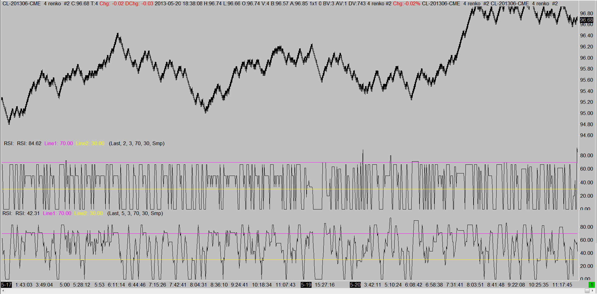

I was plotting the RSI after reading this RSI-2 thing and it appears to me to have a decided down bias. I never really used the RSI before so I could be totally wrong or maybe that's what it's supposed to do.
imageRSI.png / V - Attached On 2013-05-21 02:25:46 UTC - Size: 39.87 KB - 800 views

Maybe this shows it better. If plotted on a 4 renko bar on CL, it is oscillating between 0 and approximately 66 for a RSI(2) and 0 and approximately 83 for a RSI(5). It occasionally spikes over, but shouldn't it consistently be oscillating between 0 and 100 with a 50 centerline? Otherwise 30 and 70 or whatever are meaningless, you would have to sit there and approximate the range on every chart or in every formula for an automated entry.
imageRSI.png / V - Attached On 2013-05-21 16:24:02 UTC - Size: 59.6 KB - 772 views

I looked at it some more and it only occurs when using the simple moving average and weighted moving average. The other moving averages appear to calculate correctly. Also, the longer the period, the less noticeable the effect. Both are probably reasons why it was never noticed prior to being subjected to the scrutiny of my obviously preternatural analytical skills. So...in the end I was right, and isn't that what really matters? Let's move on. :)

I know this is a very old topic, but the problem lies in the decission to actually never allow 100, see below.
@SierraSupport: naive question, but why is 0 a valid value (when 0 == SmoothedUpSumsTemp[Index]) but 100 not?
IMHO this is not correct and leads to a bias.
  // compute RSI
  if (SmoothedDownSumsTemp[Index] != 0.0f)
  else
    RSIOut[Index] = RSIOut[Index - 1];

That code is to avoid a division by zero error.
Is this how you want it?:
// compute RSI
else
RSIOut[Index] = 100;
We can make this change.

Yes, those lovely devision by zero.
According to https://en.wikipedia.org/wiki/Relative_strength_index
If the average of D values is zero, then according to the equation, the RS value will approach infinity, so that the resulting RSI, as computed below, will approach 100.
For all practical reasons this "approach 100" should be represented by a value of 100 instead of taking the prior value. 99.99999 could do it as well for all I care ;-)
Just to give you a bit of background why I think it's wrong as it is right now: I have had a missed signal in Sierra that my backtesting platform triggered post factum. The culprint was a condition of RSI > 90 in the alert, that Sierra did not reach because the pesky prior value used with a zero SmoothedDownSumsTemp was 88.7
[2018-01-27 22:57:23]
OK understood. Change made.
Problem seems indeed to have been fixed, thank you very much.
