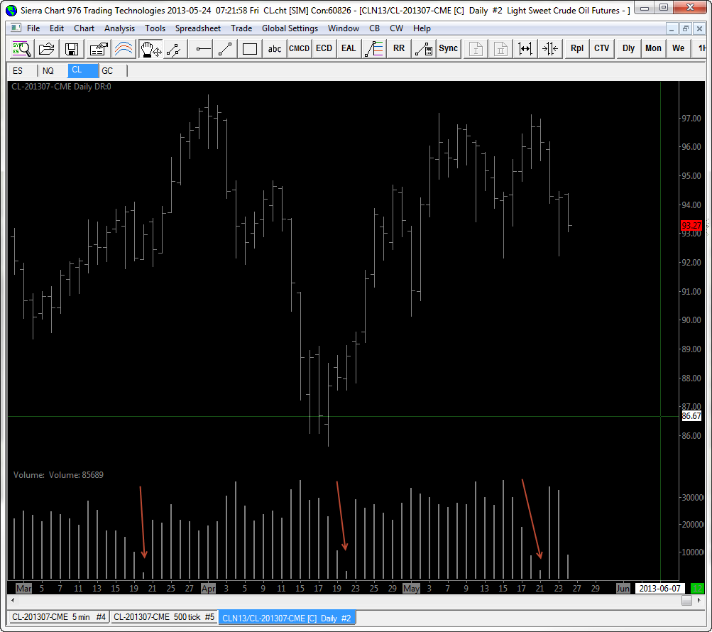

Yes Im using Method 1... i redo the method numerous times on crude oil. I tried ES and NQ...seem to be working fine. Take a look at image ... the red arrows are the rollover dates...extremely low volume leading to the rollover dates.

[2013-05-28 02:26:30]
We are checking on this.
[2013-05-28 03:00:57]
We do see the problem now and this will be resolved in the next release. We had thought we resolved this kind of problem previously.
