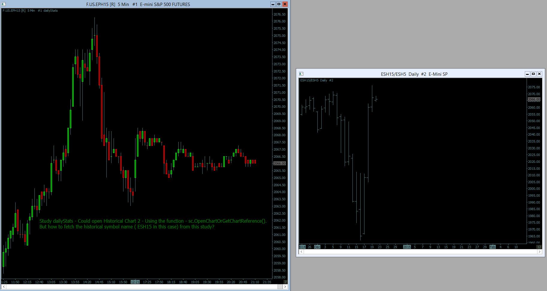

[2014-12-22 03:13:06]
ejtrader - Posts: 689
Even when I could open the Historical Chart from one of the main charts ( from chart 1 - could open chart 2 (daily chart).
But how can I fetch the historical symbol name for the study on chart 1?
if there is a possibility to add a study on chart 2 from study on chart 1 - I can then populate this symbol automatically from custom study.
Appreciate any input on this.

imagesc_OpenChart_reference.jpg / V - Attached On 2014-12-22 03:13:03 UTC - Size: 240.61 KB - 496 views
[2014-12-22 04:37:36]
These questions are not within the scope of our support and furthermore we do not recommend putting reliance on the historical chart symbol because eventually that will be hidden in the background and Historical charts will use the same symbol as Intraday charts without the Trade and Current Quote Symbol set.
