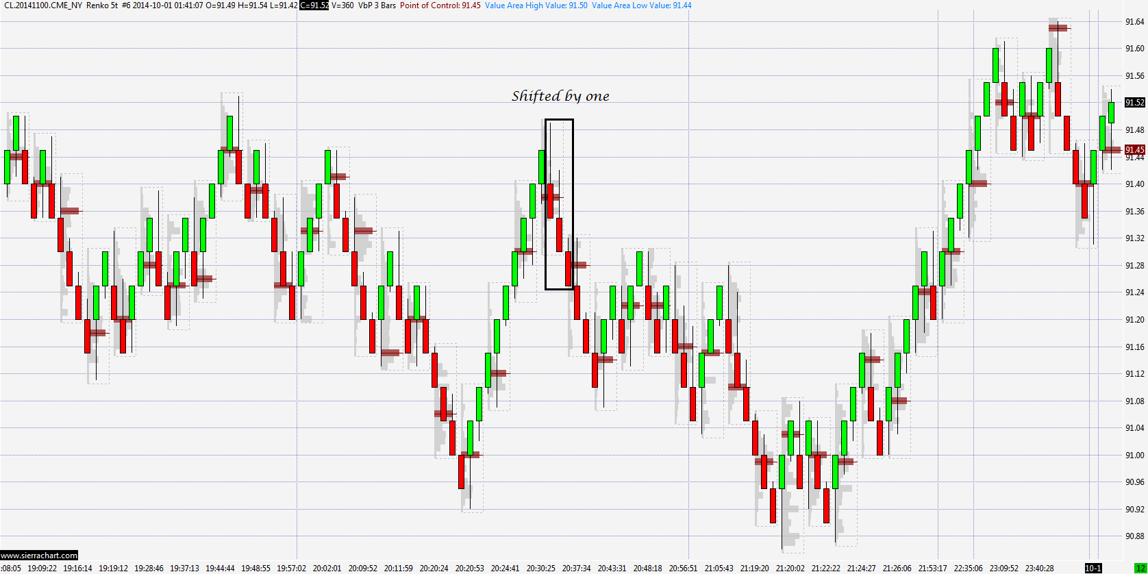

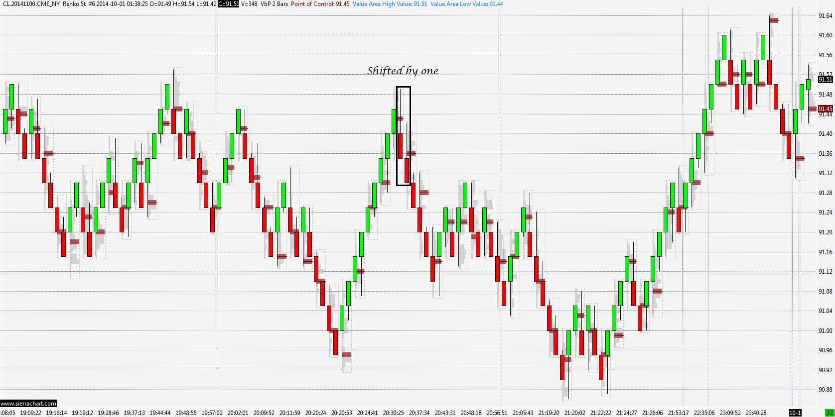

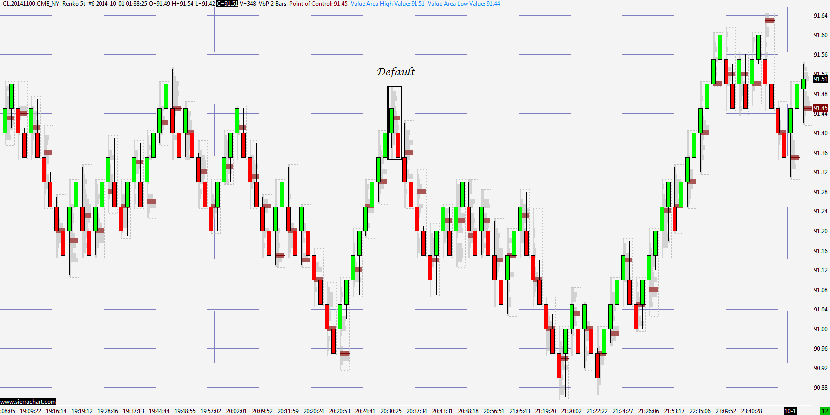

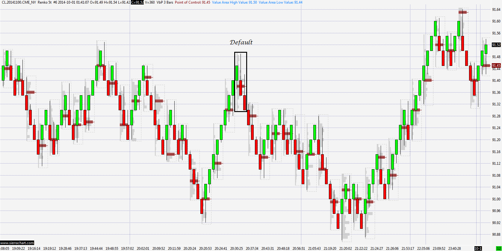

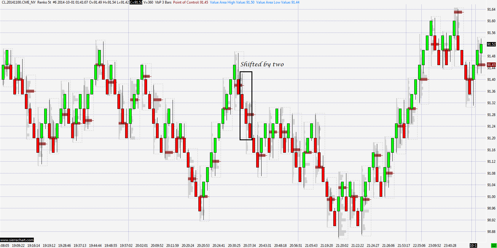

Can you make an estimate about when you're gonna implement the bar count feature, could it be in the next 2-3 months? There's one more issue with the volume profiles that are based on more than one bar count. They are calculated with the first loaded bar of the chart as a point of reference. However, as you can see from the uploaded images, there can be more combinations which are currently unavailable. I believe that a way to solve this would be to add an option to load the chart based on the number of bars besides the number of days that is currently possible.
