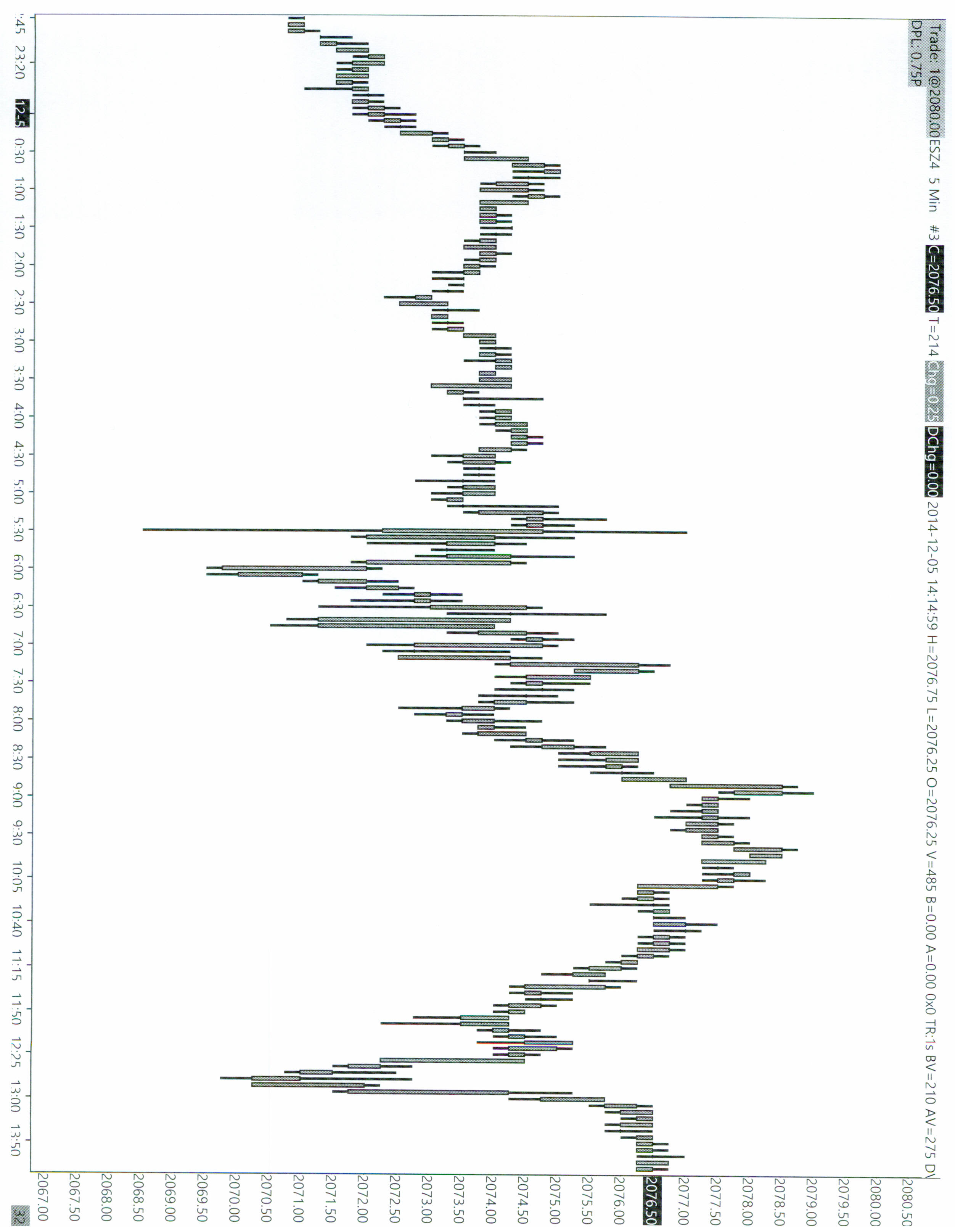

[2014-12-05 23:13:41]
User26971 - Posts: 7
http://www.sierrachart.com/image.php?l=1417820238523.png
I printed the Chart on my local printer and scanned the printout on my scanner and uploaded the .jpg file to this support instance: CCF12052104_0000.jpg
The parallel rays visible on the .png file are NOT visible on the .jpg file from my printout.
imageCCF12052014_00000.jpg / V - Attached On 2014-12-05 23:10:22 UTC - Size: 549.1 KB - 629 views
[2014-12-08 09:02:40]
Do notice a difference when this is enabled:
Global Settings >> General Settings >> Print Only in Black and White.

[2014-12-10 02:47:23]
We are able to reproduce the problem and we are looking into why this would be happening.
[2014-12-10 09:46:47]
We actually now realize the problem with the movement you see with Parallel Rays and that will be corrected in about a week.
[2014-12-12 17:36:19]
The problem with the stability of Parallel Rays when changing the chart scale has been solved in 1217 and also the printing issue as well.
The printing issue had to do with the higher resolution of printers and a coordinate limitation that was programmed a long time ago to avoid Windows driver bugs which could cause a system lockup. We hope this will not introduce the problem again but we assume this has been resolved by Windows and driver developers.
Date Time Of Last Edit: 2014-12-12 19:17:40
