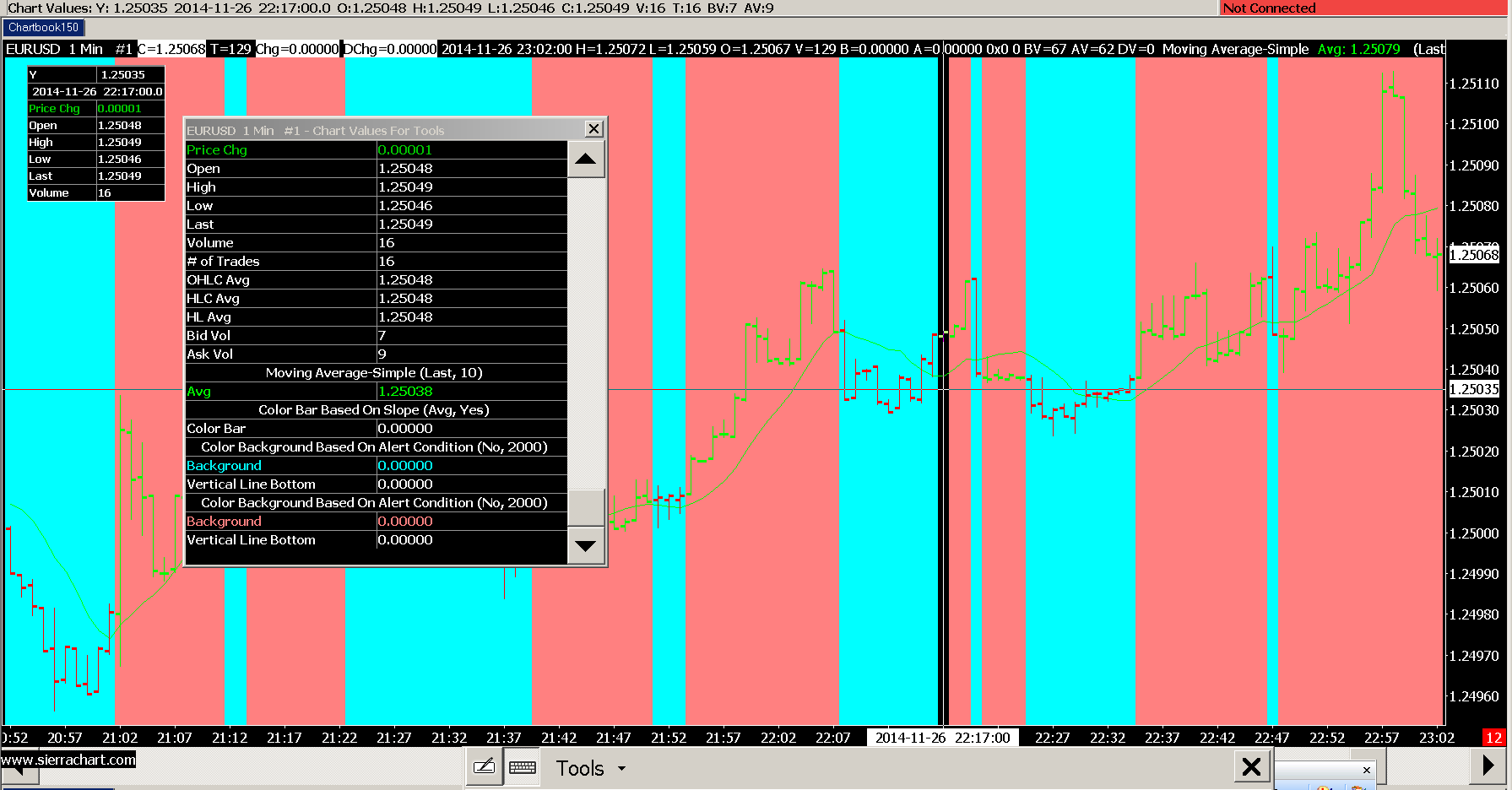

Attached chart with ALF (Laguerre) custom study indicator from User Contributed
Studies.
http://www.sierrachart.com/image.php?l=1416982208891.png
The chart has three indicators:
1. Color based on slope which is based on the ALF indicator
2. Color background based on Alert Condition which should paint Green
background if the slope(alf)=1 (=id4.sg1=1)
3. Color background based on Alert Condition which should paint Red
background if the slope(alf)=-1 (=id4.sg1=-1)
The problem:
The slope indicator is showing accurate data but the Color background based on alert condition indicator that is based on the slope indicator is not always accurate and has some "Black" holes that do not equal to the Slope indicator color value in some cases..
Please assist,
Avi
Date Time Of Last Edit: 2014-11-26 07:00:29

We have done a test and this is what we found:
http://www.sierrachart.com/image.php?l=1417161461939.png
If you examine with the Chart Values tool, the values of the Color Bar Based on Slope study you will see zero values where the Color Background study does not color the background. This is because there is no slope.
The Sierra Chart studies, work very reliably. There will not be any trouble with them like this.

avifutures - Posts: 59
When the Color Bar Based on Slope study's value equals zero it still outputs a "+1" or "-1" to the chart (if this was chosen in the selection) according to the previous chart output value, so there is a difference between the value seen on the chart and the value that appears in the Chart Values tool..
Proposed solution: Please output the chart value to SG2, so that we have the real value in SG1 and the +1 or -1 value in SG2 so it can be accessed..
