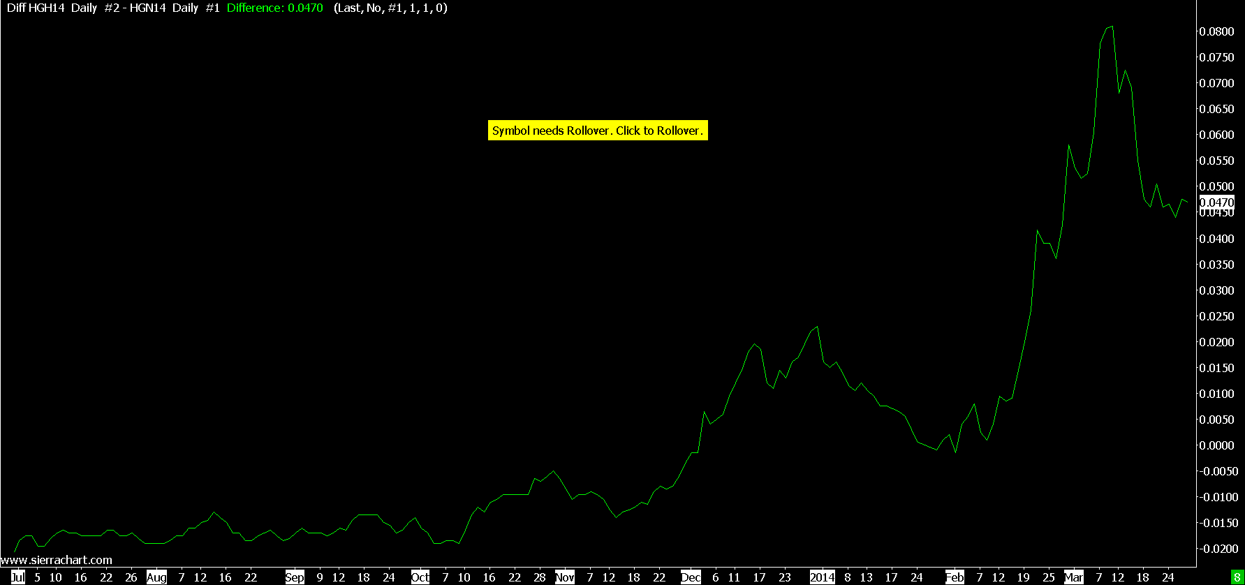

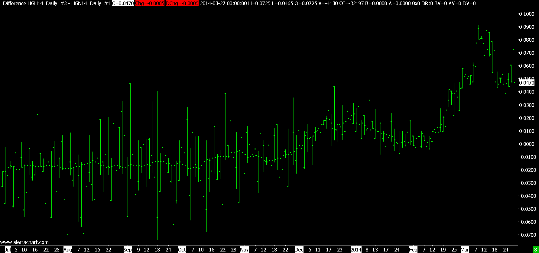

This is the result what we get for Difference (Bar):
http://www.sierrachart.com/image.php?l=1417042730258.png
Similar to yours, but different.
In the case of Difference (Single Line), there was a problem with the last trade price box where it was not matching the study Subgraph and we have fixed that :
http://www.sierrachart.com/image.php?l=1417042527825.png
