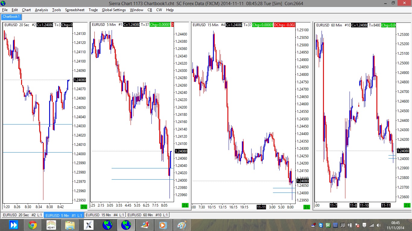

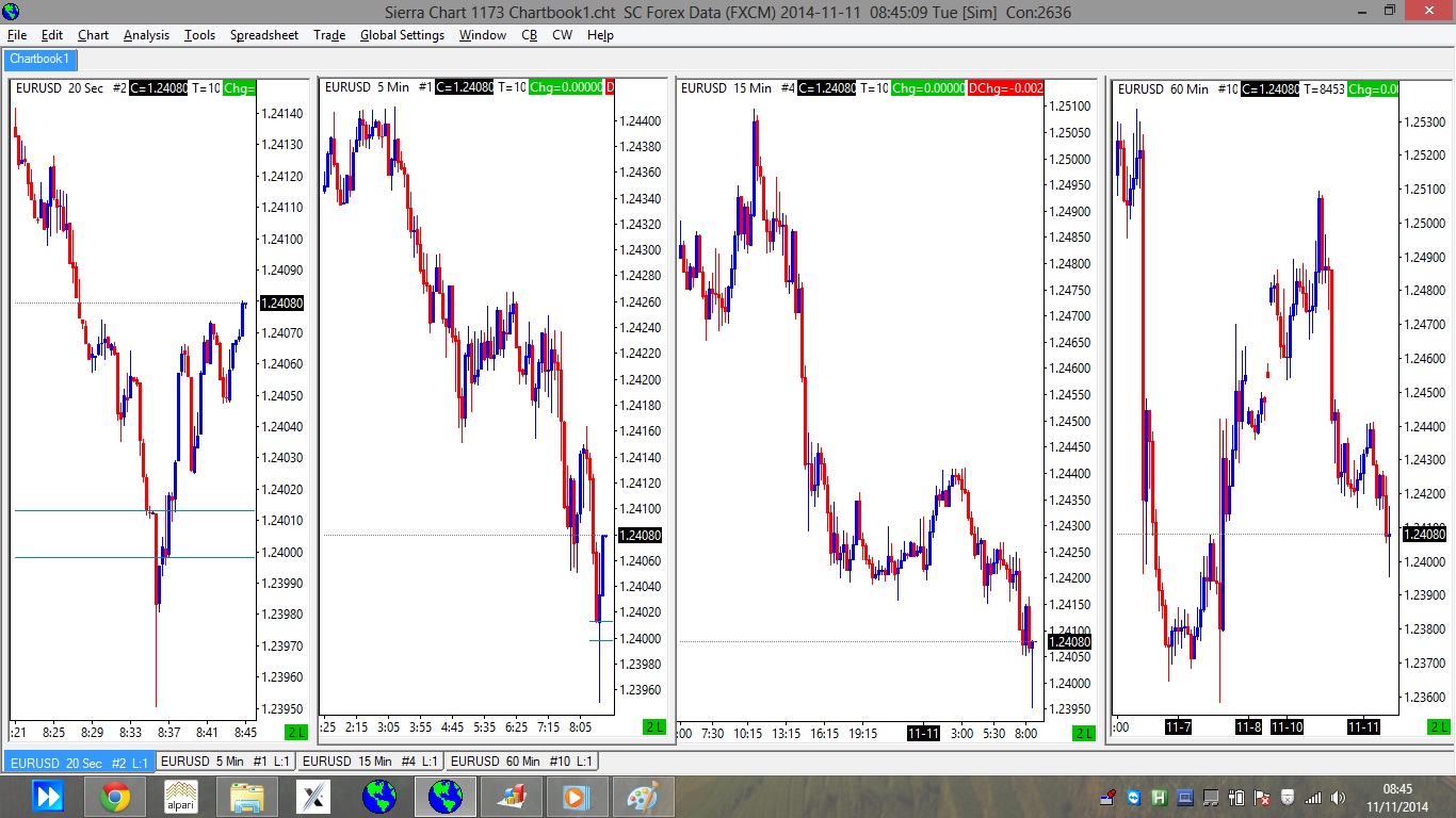

Here are screenshots to explain.
1), 2) and 3) were rays drawn on the 20sec chart. The narrow rays did not copy over to any chart. The wider rays copied over to the 5minute chart but nothing else
4) and 5) were rays drawn on the 5min chart. Narrow rays copied over only to the 20sec chart. Wider rays successfully copied over to all charts, and so were the only true function out of all 5 examples. This is my problem when in-trading.

[2014-11-12 03:23:24]
Now finally realize what the problem is. It is documented here:
https://www.sierrachart.com/index.php?page=doc/doc_ChartSettings.html#ChartDrawingsNotVisibleDestination

[2014-11-12 17:19:36]
We do not regard this as being something to fix. It works as designed. The problem does not relate to the price difference. It has to do with the number of bars that they span.
