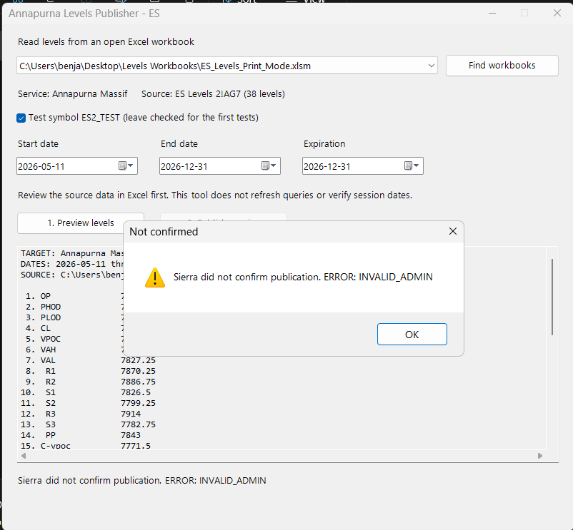

The response is:
ERROR: INVALID_ADMIN

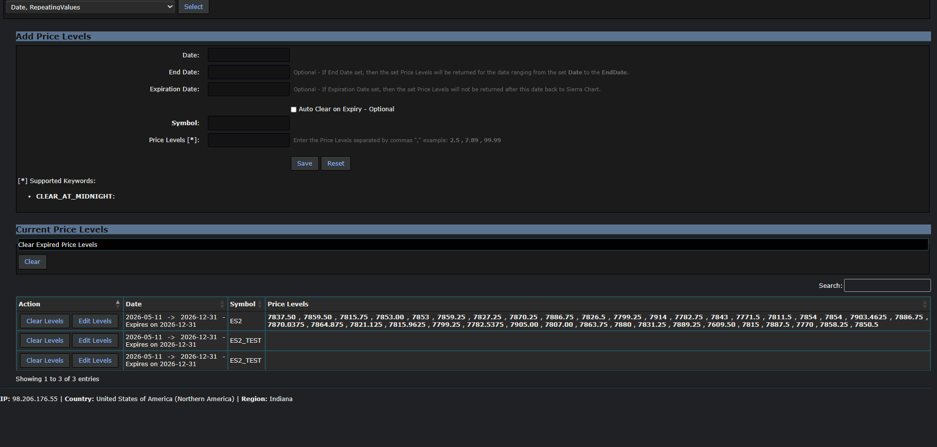

During testing, two ES2_TEST entries appeared with the requested dates but no price levels, as shown in the attached screenshot. The existing live ES2 entry remains populated. A subsequent attempt returned INVALID_ADMIN without adding another entry.
Could you please clarify why this account is rejected by the API, and whether any additional authorization or request changes are required? I suspect the 'edit/save' function needs to be accessed somehow.. but not sure how.
