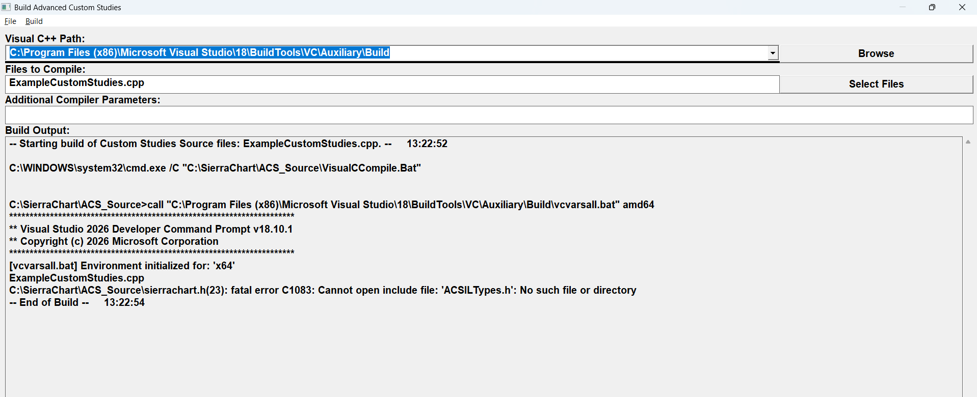

Hello Sierra Chart Support,
I am having an issue compiling ACSIL studies after updating Sierra Chart.
My Sierra Chart version is 2955.

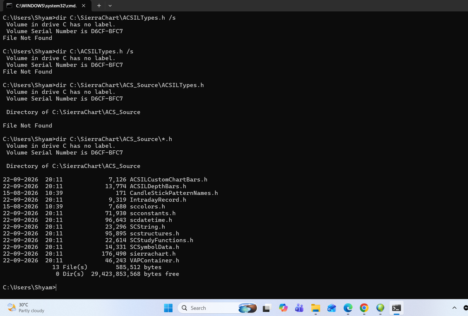

In my installation:
C:\SierraChart\ACS_Source\sierrachart.h
line 23 contains:
#include "ACSILTypes.h"
However, ACSILTypes.h does not exist in:
I confirmed this using Command Prompt.
I also searched the entire ACS_Source folder and found that several other header files reference ACSILTypes.h, including:
ACSILCustomChartBars.h
ACSILDepthBars.h
IntradayRecord.h
scconstants.h
SCString.h
scstructures.h
SCSymbolData.h
sierrachart.h
VAPContainer.h
I first encountered this while trying to compile my custom study TradeMap.cpp.
To determine whether the problem was with my custom code, I also tried compiling Sierra Chart's built-in:
ExampleCustomStudies.cpp
using Build With Visual C++ – Release.
It failed with:
fatal error C1083: Cannot open include file: 'ACSILTypes.h': No such file or directory

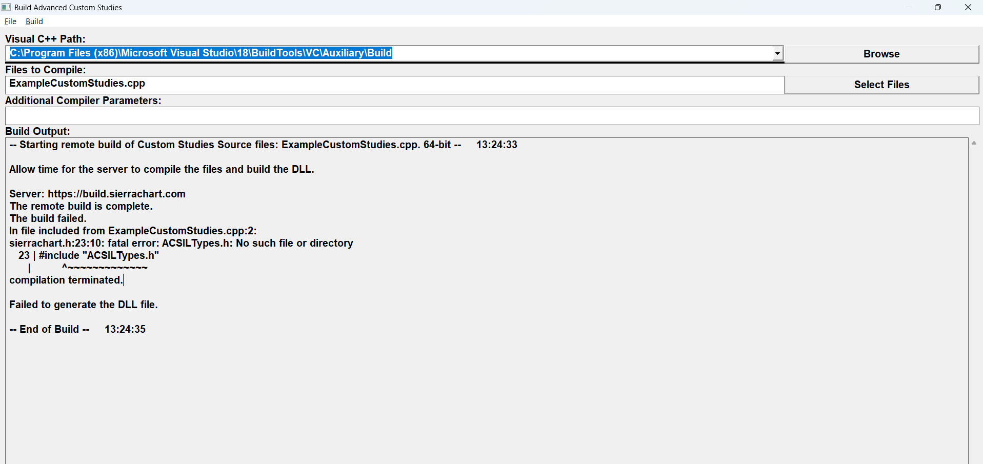

I also tested Remote Build – Standard, and it failed with the same error:
sierrachart.h:23:10: fatal error: ACSILTypes.h: No such file or directory
I have already updated Sierra Chart twice today, but the file is still missing.
Could you please advise where ACSILTypes.h is supposed to come from and how I can restore the correct ACSIL source/header files?

[2026-09-22 18:09:46]
Sierra_Chart Engineering - Posts: 25392
We apologize for this. We are resolving this right now.
You just need to update Sierra Chart again with Help >> Download Current Version.
We did make the necessary code change to add this file, but there was one step, we did not perform related to it.
Just give us a few more minutes.
[2026-09-22 18:23:10]
The new release is out now.
