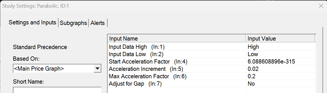

The prior code was:
Input_StartAccelerationFactor.Name = "Start Acceleration Factor";
Input_StartAccelerationFactor.SetFloat(0.02f);
Input_StartAccelerationFactor.SetFloatLimits(0.000001f, static_cast<float>(MAX_STUDY_LENGTH));
The new code is:
Input_StartAccelerationFactor.SetDouble(0.02);
Input_StartAccelerationFactor.SetFloatLimits(0.000001, MAX_STUDY_LENGTH);
When I add the study, it shows a ~6e-315 value and selecting the input changes the value to 0, and no value seems valid to enter there.
I cannot see the internals for how Set*Limits() is implemented, but I am guessing the union where FloatValueMin/Max are being set are not the right values/size and the SetDouble() is causing the code to correctly use DoubleValueMin/Max because of "ValueType = DOUBLE_VALUE;" in the SetDouble() call.

We will look into this. It is fine in version 2949. If you need to go back to 2949, then follow these instructions:
Software Download: Full Control Rollback Procedure
[2026-09-15 19:42:36]
Sierra_Chart Engineering - Posts: 25339
We apologize for this. We started work on this, but did not finish it at the time release was made.

User719512 - Posts: 521
Fixed in v2952. Will take some getting used to the "look" of the new/extra digits after the decimal for doubles, but this is a huge step forward everywhere. Great updates to all the other studies. Thx Sierra!
