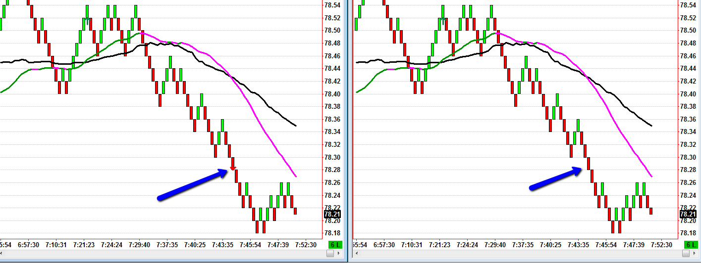

If you have a moment, please see attached. The chart on the left is the original. On the right is a duplicate with your code substituted. You can see on the left a signal exists on the left (red arrow, barely visible) as the line is sloping down, and the lines cross as specified, but on the chart on the right it does not show. So I think there might be something amiss. If you have the spare time to look again, that would be great. I will keep at it either way.
Thanks,
Patrick Z
image12345.png / V - Attached On 2014-11-06 12:55:03 UTC - Size: 39.29 KB - 507 views

My formula works on my test chart. It signals when ID3.SG1 crosses ID2.SG1 from below, and there are 5 consecutive previous downslopes of ID2.SG1, where ID3.SG1 is the slower of the two MAs.
I find it easier to base the crossover on the faster MA. (The first ID# in the formula is the what crosses the second.):
=CROSSFROMBELOW(fasterMA,slowerMA)

Referring to the example pic, if ID3 is the black line and ID2 is the magenta line, then my formula should work.
