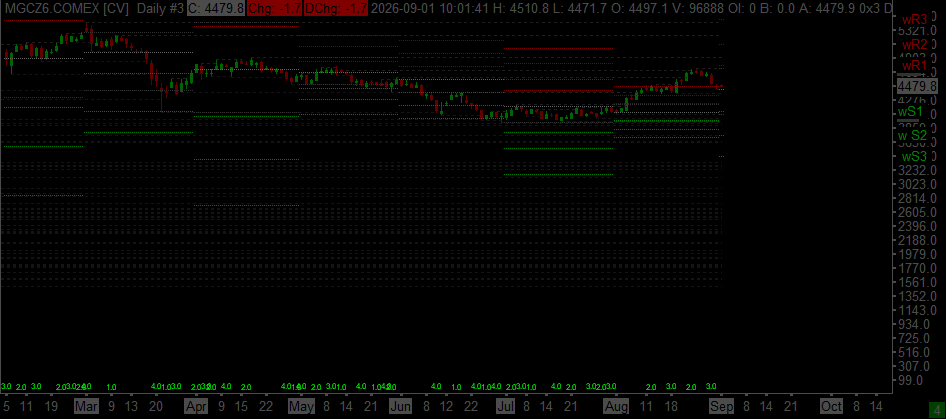

There should not be green number below.
imageMGCZ6.COMEX [CV] Daily #3 2026-09-01 10_01_42.608405.png / V - Attached On 2026-09-01 07:02:55 UTC - Size: 22.34 KB - 64 views

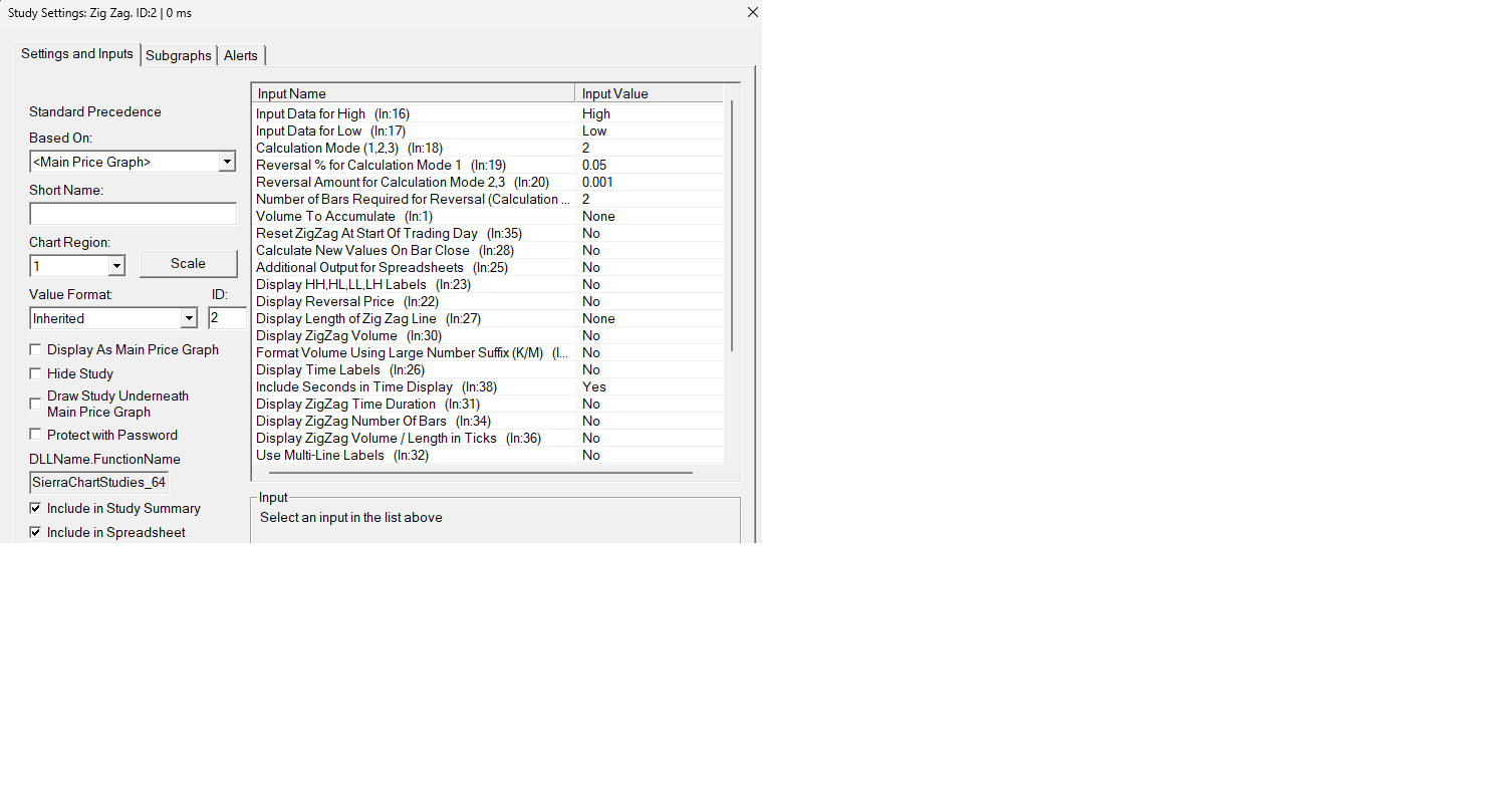

imagesettings.png / V - Attached On 2026-09-01 07:05:02 UTC - Size: 69.77 KB - 40 views
[2026-09-01 07:18:37]
Sierra_Chart Engineering - Posts: 25199
We do not see a problem like this.
Save the Chartbook with File >> Save, and then remove the zigzag study from the chart. Do the numbers get removed?
Date Time Of Last Edit: 2026-09-01 07:18:52
[2026-09-01 07:39:03]
User84094 - Posts: 58
Yes.
Earlier the numbers were far left in beginning the chart (not visible but scrolling into far left I saw them ).
But now numbers are from beginning of chart to the end.

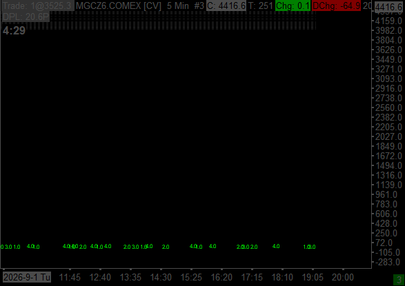

[2026-09-01 16:13:15]
Yes this is still a issue.
I downloaded latest version and it didn't help either
imageMGCZ6.COMEX [CV] 5 Min #3 2026-09-01 19_10_30.381282.png / V - Attached On 2026-09-01 16:13:06 UTC - Size: 15.83 KB - 36 views
[2026-09-01 16:38:05]
John - SC Support - Posts: 48237
You are displaying something that you should not be, such as the "Zig Zag Oscillator" subgraph. But with that subgraph, you should have numbers at every bar, so we do not think it is that exactly.

imagezz.png / V - Attached On 2026-09-01 16:49:14 UTC - Size: 110.36 KB - 36 views

[2026-09-01 20:01:09]
You changed to the "Draw Style" for the "Text Labels (SG2)" to be "Transparent Custom Value at Y Left Aligned". This must be left as "Custom Text" for the study to work properly.
Please change that item back to "Custom Text".
