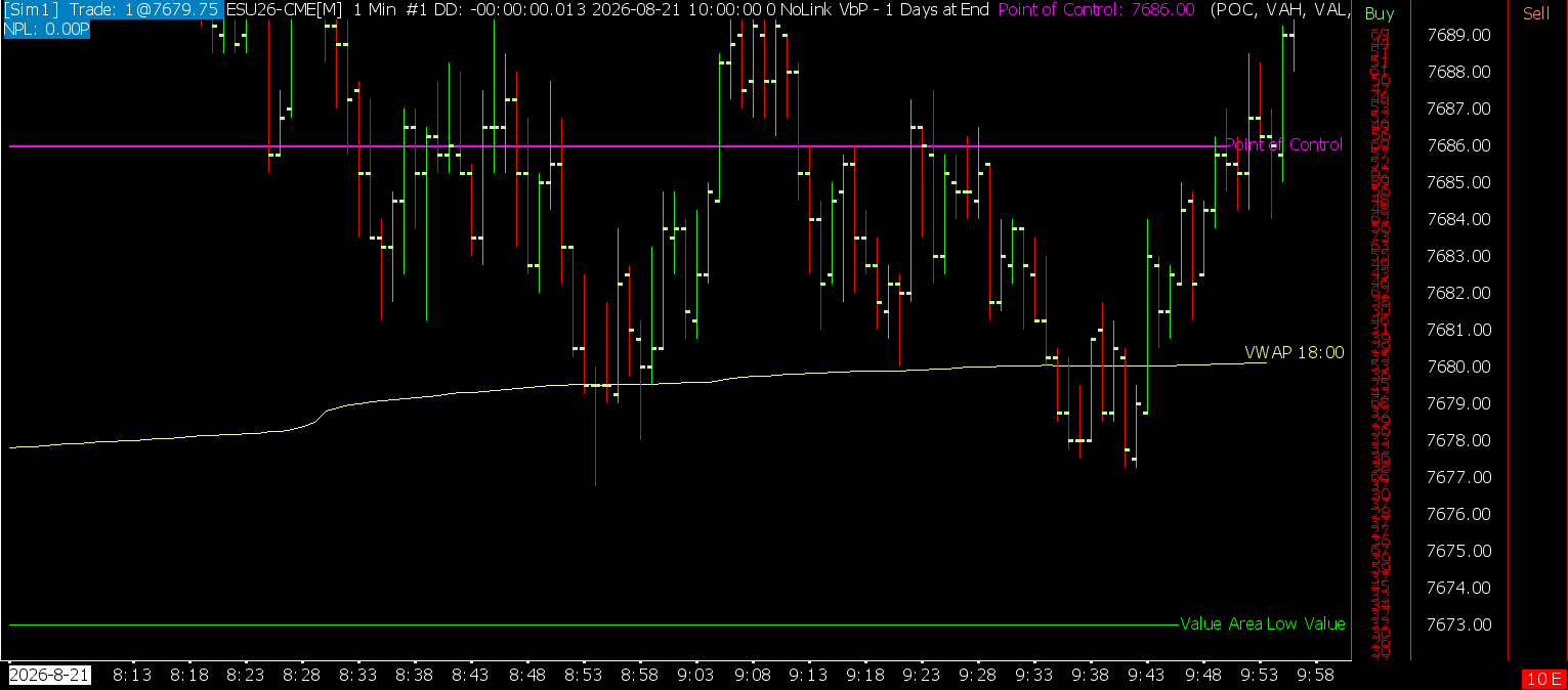

We assume that you are referring to the fact that the VWAP line is drawing through the text of the label. If it is something else, then let us know.
We are not able to reproduce what you are seeing. The line does not draw through the label text for us, and we are unable to find a setup that will cause this, apart from having a separate study that is drawing that line. Attached is an image of what we see.

I am reffering to the fact that "Value Label" on the price scale for the subgraph VWAP is not visible.

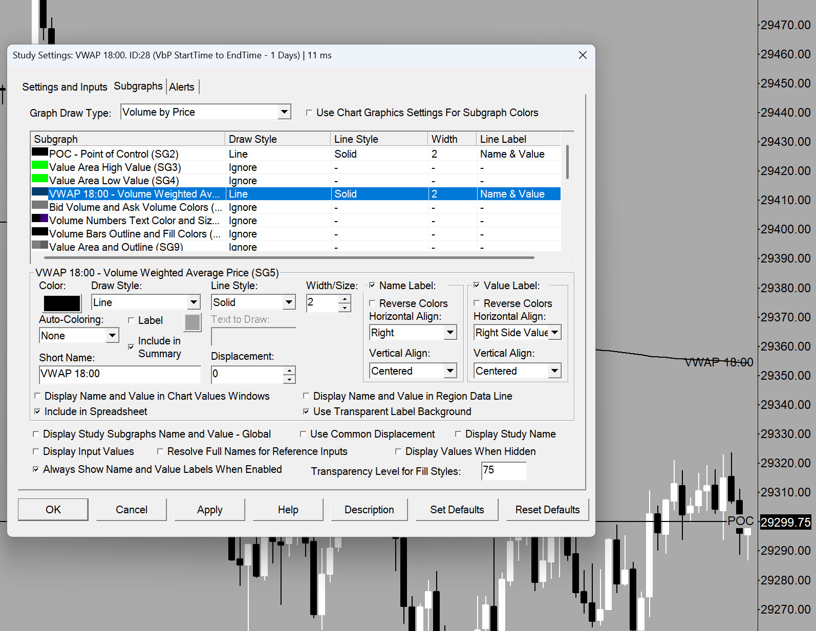

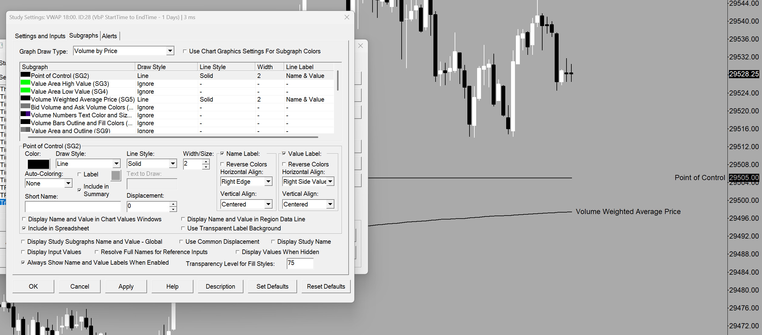

look at the difference between point of control and VWAP on price scale. Both are checked at "Value Label" and "Right side Values Scale". Both have the same color. Only point of control is visible on values scale.

For the "Volume Weighted Average Price" subgraph, you have the option for "Use Transparent Label Background" enabled. You need to disable this.
[2026-09-01 15:38:19]
TraderBake - Posts: 63
Thank you so much. I really didn't see this.
