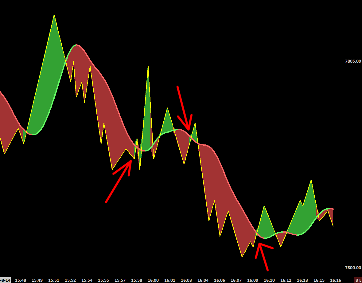

esMike - Posts: 83
I have tried to find a solution to this problem with Claud, Chat GPT, and Codex models.
No Ai model can find a solution to this graphing issue. It's very simple... I need a clean color fill between two different chart lines which also tracks those lines exactly.
One model attempted to use additional black color fills to patch over the issues, but that did not work.
imageissue.png / V - Attached On 2026-08-15 09:02:49 UTC - Size: 30.74 KB - 114 views

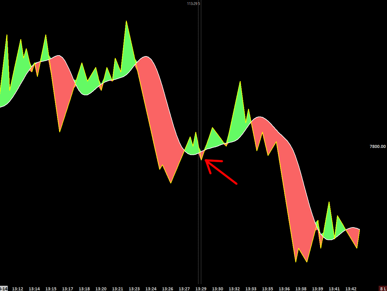

[2026-08-15 09:36:15]
esMike - Posts: 83
By using four graphs for two fills, instead of two graphs, the up/down color issue can be resolved, but that still does not fix this drawing issue when the crossover is not exactly at the line during the transition.

[2026-08-17 19:49:15]
John - SC Support - Posts: 48562
Please get us the first chart that you posted, as there is something odd about what you are doing, but we are not sure what it is. Follow these instructions to get us the chart:

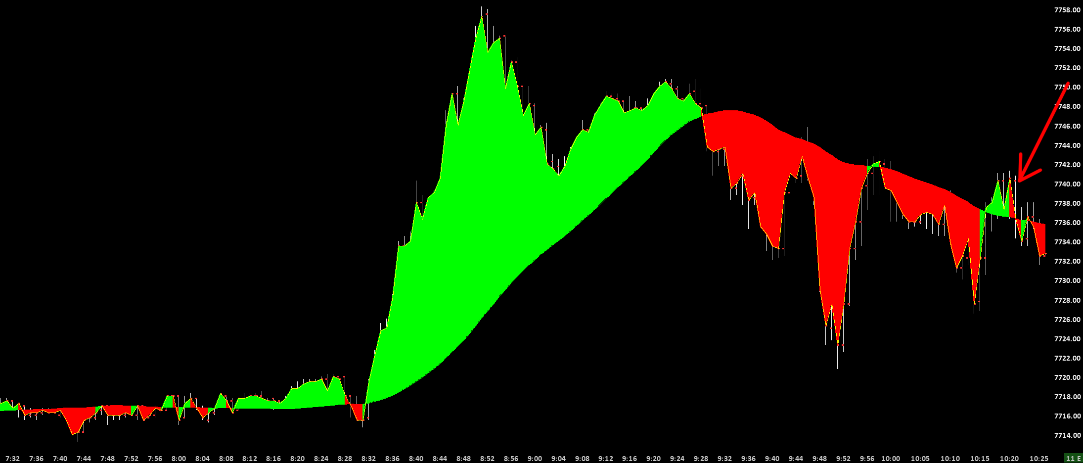

[2026-08-19 14:26:37]
esMike - Posts: 83
Here, the issue can be demonstrated just with the moving averages study.
Date Time Of Last Edit: 2026-08-19 14:28:17
attachmentchartBookDemo.Cht - Attached On 2026-08-19 14:25:44 UTC - Size: 4.16 KB - 82 views
imagechartBook.png / V - Attached On 2026-08-19 14:28:13 UTC - Size: 52.41 KB - 92 views
[2026-08-19 14:46:05]
What you are doing is the best that can be done. The underlying issue is that the coloring is set between bars. So when a crossover occurs between bars, the coloring will not change until the next bar starts.
This is just built into how Sierra Chart works, and it is not something that could easily change.
