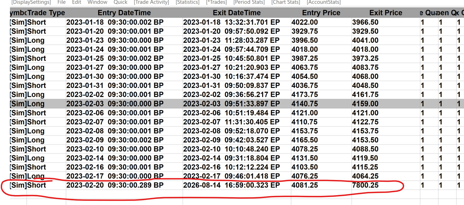

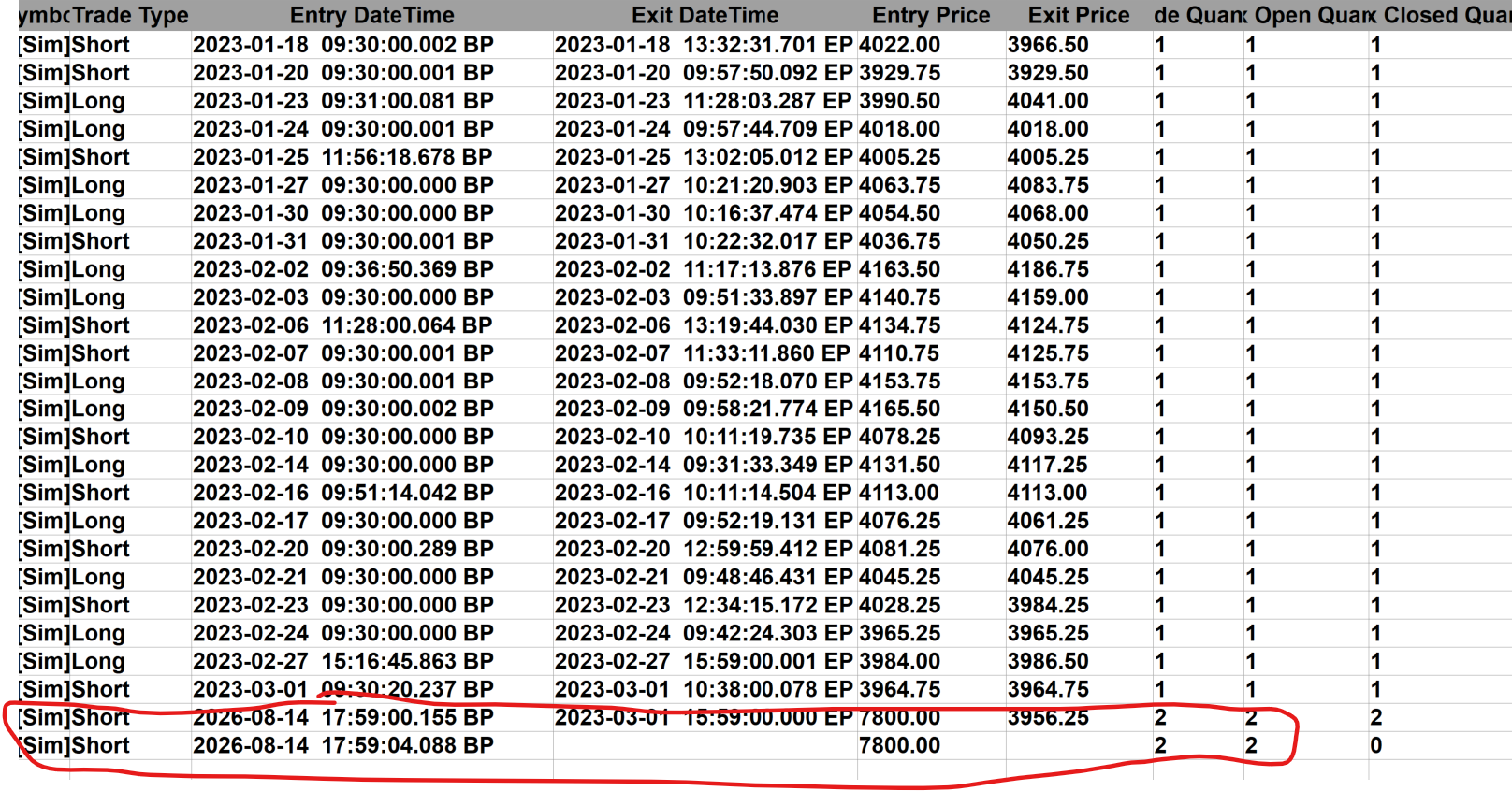

I'm running a replay in Accurate Trading System Back Test Mode.
There are multiple instances of random fills generating during the replay when my system isn't trading.
I am not connected to the data feed during the replay. Also, at the time of this writing and the time of the replay, the market is closed for the weekend.
These random orders pop up and disappear and then I notice a significant change in the Trade Statistics of my test with entries on the Trades Tab for trades my system didn't place for prices outside of the test period.
I've attached two screenshots of the Trades Tab post these events. Each have fills with entries and exits as if trades were being held for multiple years as a result of entering during the test period and exiting today or vice versa.

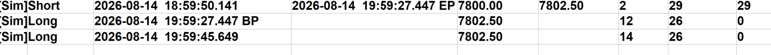

Also, there are instances where attempting to cancel these phantom orders doesn't flatten them. They continue to persist during the replay in quantities inconsistent with the system. (i.e 3rd screenshot)
Can someone advise how to correct/prevent this during replays.

[2026-08-17 20:16:03]
First of all, if you have not cleared the trading data for the symbol and account you are using for the replay, then this would be the existing orders showing up at the time those orders occurred. In other words, these are existing orders showing up in your chart during the replay.
Make sure you use a "clean" account or clear the data prior to starting the replay.
If not the above, then you need to look at your trading system, as they could only be coming from there.
