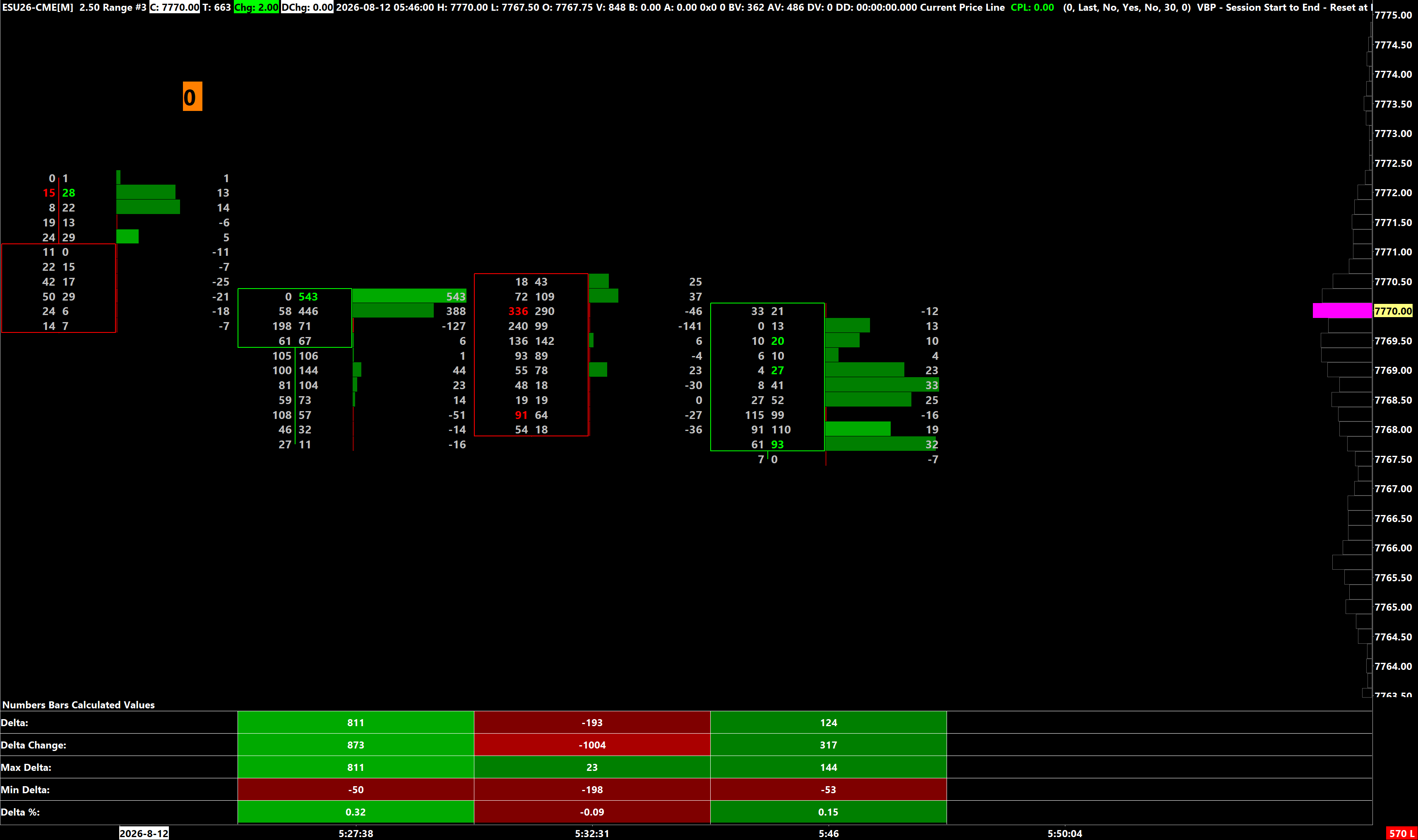

I am using Numbers Bars on an ES footprint chart.
Symbol: ESU26-CME[M]
Chart type: 2.50 Range
Study: Numbers Bars
Column 2 Background Type: Ask Bid Difference Profile
The profile looks correct when I zoom in horizontally. For example, at 2026-08-12 05:27:38, the Column 2 Ask Bid Difference Profile displays correctly inside/near the bar, and I can read the bid/ask numbers and the red/green profile.

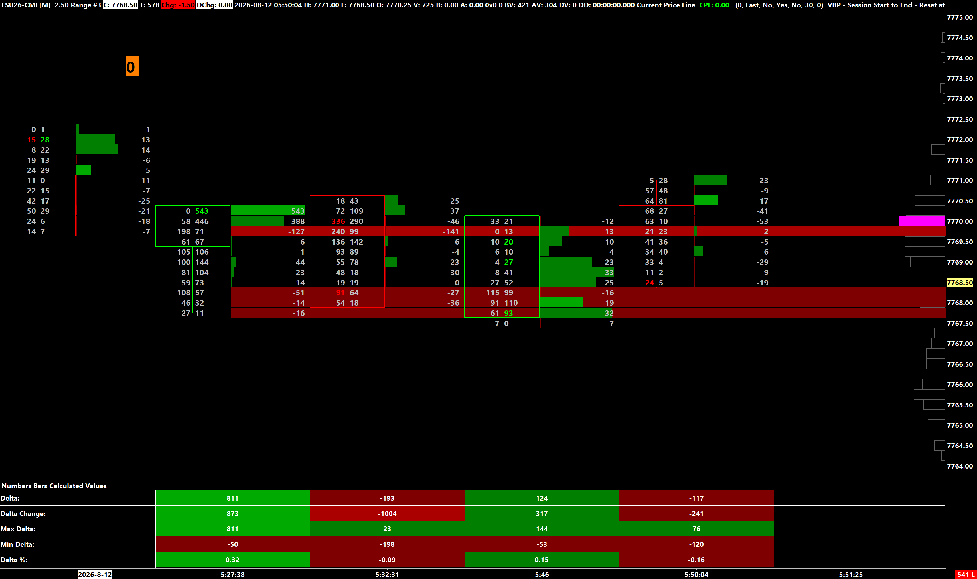

But when I zoom out horizontally, the red part of the Column 2 Ask Bid Difference Profile stretches far to the right and looks like a thick red horizontal line across later bars. It covers the chart and makes the footprint hard to read.
This is not coming from:
- Volume at Price Threshold Alert
- Highlight Nonzero Bid&Ask Volume at High/Low
I have already checked:
Highlight Nonzero Bid&Ask Volume at High/Low = No Columns
Question:
Is there a Numbers Bars setting that keeps the Column 2 Ask Bid Difference Profile clipped inside each chart bar/Numbers Bar column when horizontal spacing is reduced?
Or is this expected behavior when using Ask Bid Difference Profile and the only solution is to increase horizontal spacing, change Column 2 Background Type, or disable the profile when zoomed out?
I want to keep Column 2 as Ask Bid Difference Profile, but I do not want the profile background to draw across later bars when I zoom out.
Should I adjust:
- Volume Profile Bars Length Relative to All Visible Bars
- Spacing Adjustment Value
- Column 2 Background Type
- another setting?
I attached two screenshots:
1. 05:27:38 zoomed in: correct display
2. zoomed out: red profile becomes a long horizontal red band
https://www.sierrachart.com/image.php?Image=1786539721291.png
https://www.sierrachart.com/image.php?Image=1786539896349.png
[2026-08-12 14:13:03]
Provide us this chart, following these instructions:
[2026-08-12 14:42:08]
SOXL5408 - Posts: 3
I attached the chartbook file with single chart with only one study.
attachmentChartbook1_support.Cht - Attached On 2026-08-12 14:40:33 UTC - Size: 4.65 KB - 89 views
[2026-08-13 14:55:48]
We tested your Chartbook and do not see what you show in the second image, in post #1.
It looks just fine to us.
What is this setting set to on your side:
Global Settings >> Graphics Settings - Other >> Small Widths >> Small Widths >> Numbers Bars Volume Profile Bar Minimum Width : 5
We also want you to update Sierra Chart to the current version. Instructions:
Date Time Of Last Edit: 2026-08-13 14:56:34
