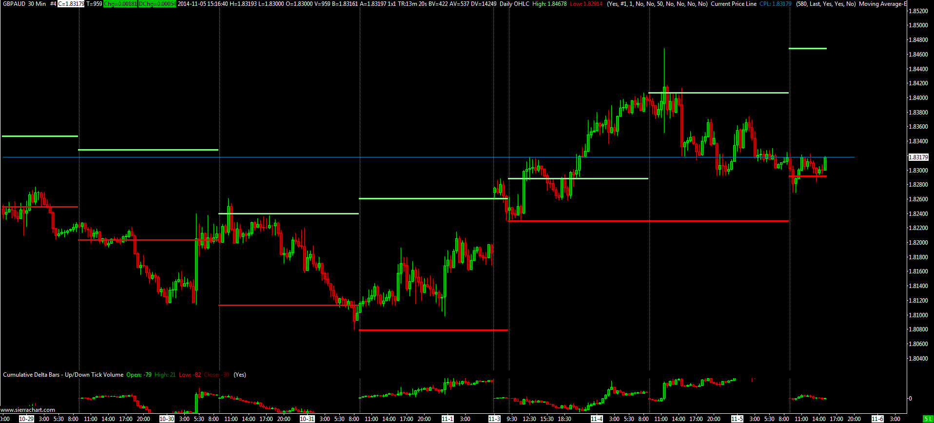

User97916 - Posts: 10
The green and red lines on the chart are yesterdays highs and lows. As you can see on Monday these lines are in the wrong spot because of the extra bars between the 2 vertical lines. http://www.sierrachart.com/image.php?l=1415161004480.png

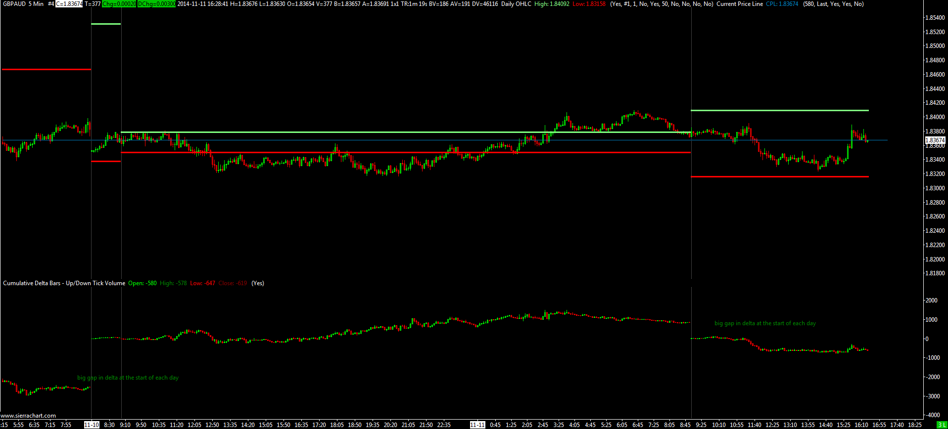

http://www.sierrachart.com/image.php?l=1415683726383.png
Hi, The delta study has gaps at close and open of each day as shown in attached screenshot. I mentioned the time zone settings I am using in my first post. Pls confirm these are correct. As I only downloaded Sierra about a week ago. I am unable to see any specific issues that do not look right as I am unfamiliar with the platform. Once this problem is sorted am I able to get an extension of the free trial as it has seemed pointless using the charts when the indicators are not right. Thanks - CAthy
[2014-11-11 07:37:35]
There is no right or wrong for the Session Times. You can find complete documentation for setting them here:
Chart Session Times
Although it might be best to set them to the London time zone. However, this is up to you.
If you do not want the Cumulative Delta Bars study to reset at the start of each trading day, then set the Reset at Start of Trading Day Input with the study to No.
We have given you a trial extension.
Date Time Of Last Edit: 2014-11-11 07:39:00
My original problem has not been solved !! I still have the two vertical lines on the weekends. As you can see from the charts I have previously sent you, the yesterdays highs and lows (green and red lines) are wrong on Mondays. I am unable to use the daily pivot either as these two vertical lines on the weekend are throwing out the calculations for the pivots. Please help as I am getting frustrated this is taking so long to resolve. This problem is preventing me from setting up the charts with my preferred indicators.
[2014-11-12 03:53:33]
Set the time zone to London time. Here are the instructions:
Time Zone Setting
For the Session Times for the chart use a Start Time of 22:00:00 and an End Time of 21:59:59.
Also in Chart Settings uncheck Load Weekend Data.
