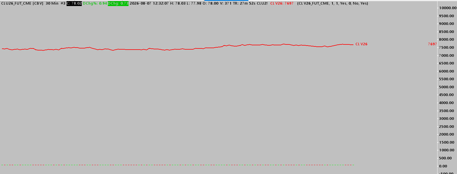

I am using add additional symbol the my chart. I am using automatic scale. I can't seem to get the Y axis scale right to go with the scale of main chart- CLV26 should be 76.80 not 7680.

John - SC Support - Posts: 48459
The "Real-Time Price Multiplier" for CL when connected to Teton CME Routing (i.e. when you are using a symbol of CL?##_FUT_CME) is 0.01. This is handled internally through the symbol settings, so it is not something you would normally need to think about.
But, when you use the "Add Additional Symbol" study, that does not have a way to update that symbol per the symbol settings for that symbol. Therefore, you need to set the "Price Multiplier" in the Add Additional Symbol to "0.01" for this particular situation.

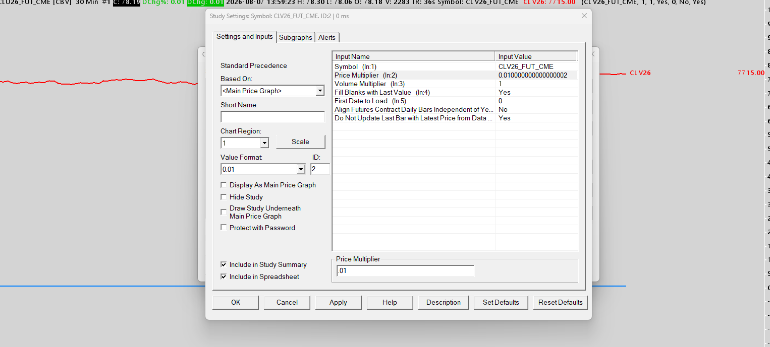

ok, I'm not sure it affects anything, but when I went in to put .01 as price multiplier it added zeros then 2 at end? See Attached.
That is a floating point rounding "thing". It is not important, but we will check why the Input is showing like that. We noticed this ourselves one time, but thought it might be related to something else.
