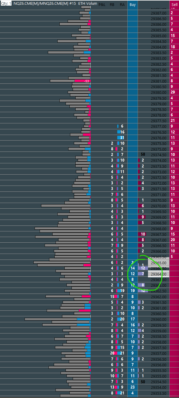

I am also facing similar issues with compressing the DOM. My settings are the same as his and I have applied Yes to Apply Combine Increment in Ticks to Other Market Data Columns. However, the recent bid/ask columns looks off and noticed that the pull/stack column tend to stack above one another at the same price
1. Chart -> Chart settings -> Market Depth -> Market Depth Increment combine set to 2
2. Chart -> Chart settings -> Scale (button) -> scale increment = 0.5
3. Chart -> Chart settings -> Symbol -> Tick size = 0.25
imageScreenshot 2026-09-14.png / V - Attached On 2026-09-14 02:25:49 UTC - Size: 103.88 KB - 73 views

What is the column where you have the information circled and there is a value of 1 in an odd position?
[2026-09-14 20:06:07]
Aloy - Posts: 4
Its a pull stack column. I have only put to show the stacking of market depth.
I think the value of 1 in the pull stack column 29364.75. Would you recommend that I change Chart -> Chart settings -> Symbol -> Tick size = 0.25 to 0.5 instead?

There is some reason for this.:
This is only at the very top of the values, by the last trade price. Probably to prevent an overlap with the other side (ask or bid), that potentially can occur when combining levels.

[2026-09-15 00:14:35]
Aloy - Posts: 4
Are there any fix for this?
[2026-09-15 01:39:55]
No. This is by design. Also it needs to be understood that mathematically, it is 100% impossible to prevent overlap when combining price levels, at the point where bid and ask prices are side-by-side each other.
Date Time Of Last Edit: 2026-09-15 05:03:53
