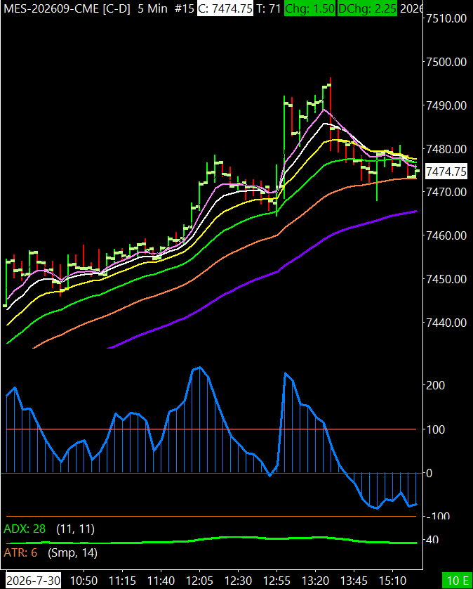

I am using Sierra Chart v2761 in Trade Simulation Mode with the Sim1 account. Trade Simulation Mode is ON. Trading Locked is OFF. Chart Trade Mode is ON. Auto Trading Enabled - Global is ON. Auto Trading Enabled - Chart is ON. When I click BUY MKT on the Trade DOM, Sierra Chart displays the Confirm Order dialog correctly. After I click Yes, the dialog closes, but absolutely nothing happens. No parent order is submitted, no position is opened, and the Trade Service Log shows no order submission or rejection messages. What setting or condition could cause the order to be ignored after confirmation? |

I have done additional testing. Trade Simulation Mode is ON. Trading Locked is OFF. Chart Trade Mode is ON. Account is Sim1. Order Type is Market. Time in Force is Day. Flatten works correctly and closes the position. The position is now Flat. When I click BUY MKT or SELL MKT, the confirmation dialog appears. After I click Yes, nothing happens. No new position is created. The Trade Service Log shows no new order submission or rejection messages. Is there another setting that would prevent new entry orders while still allowing Flatten to work? |
