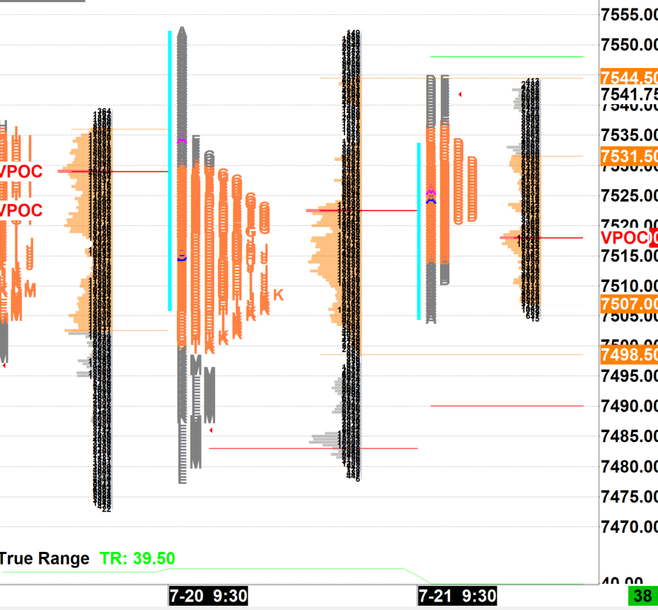

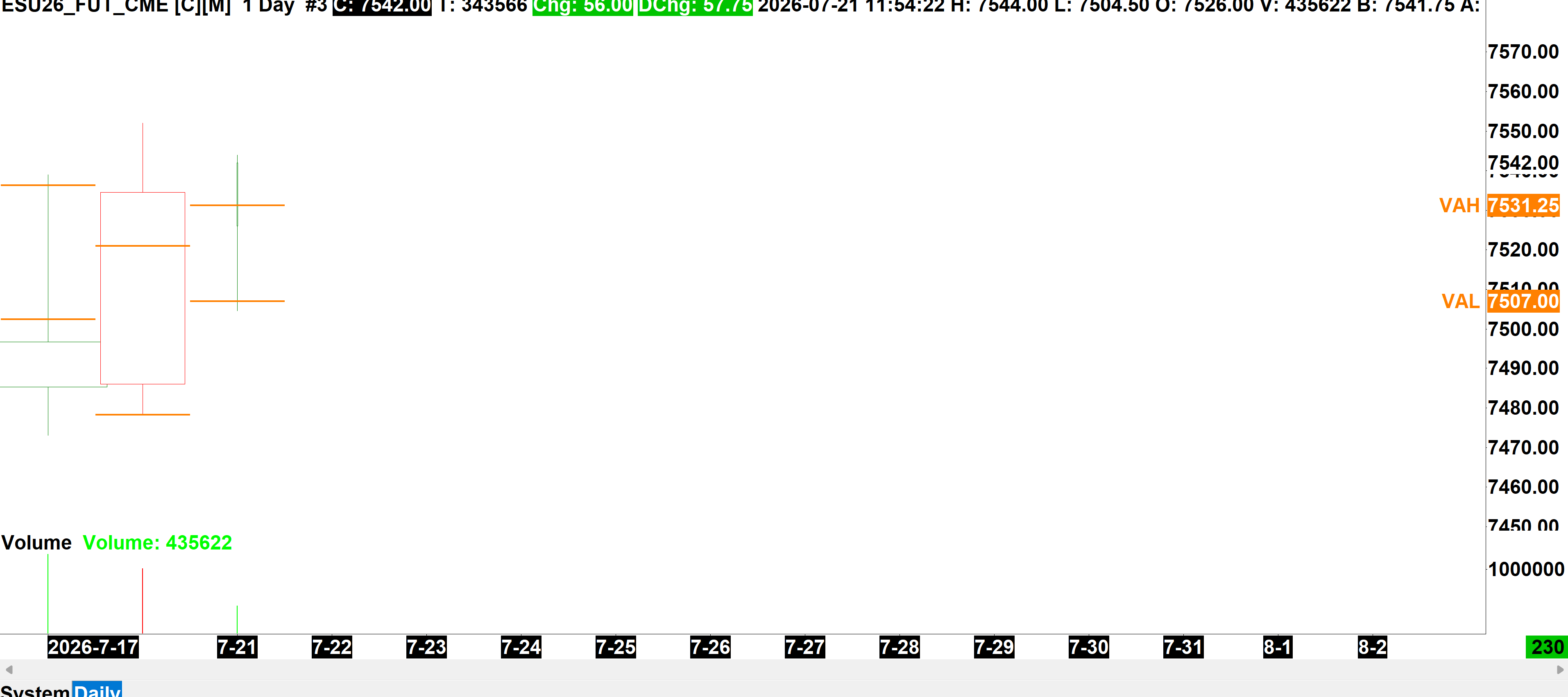

I have two charts, a Daily and a Profile, with the same time zones and session times.
The Daily Chart contains the Volume Value Area Bars Study.
The Profile contains the TPO Profile Study and the Volume By Price Study.
All studies use the default 70% to calculate the value area.
I've noticed some discrepancies between the Volume Value Area Bars on the Daily Chart and the Volume by Price Study on the Profile Chart. For the current session, the VAH or VAL may vary by one tick between them.
However, for prior sessions this variance is significant. For example, in the screenshots provided, for the current session at the time of the screenshot, the VAH was 7531.50 on the Profile Chart, but 7531.25 on the Daily Chart's Volume Value Area Bars Study. The VAL's matched across both charts.
Looking at the prior session however, 20th July, the Profile Chart has a VAH of 7544.50 and a VAL of 7498.50 while the Daily Chart's Volume Value Area Bars Study has a VAH of 7521.00 and a VAL 7478.25
Can someone advise how this can be corrected?

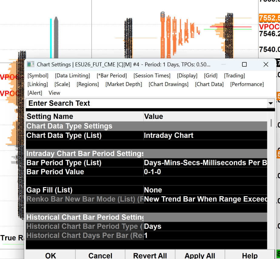

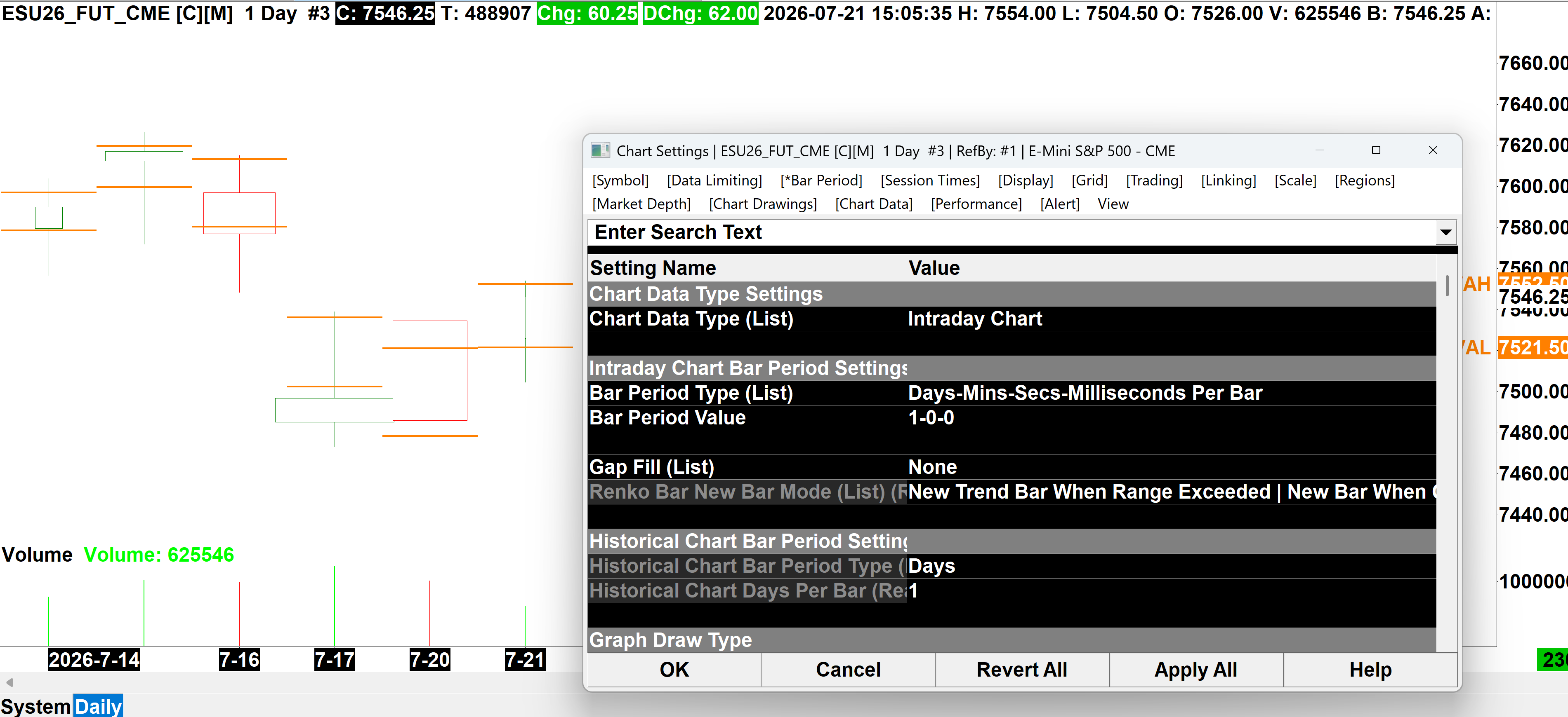

Gradient - Posts: 219
The variance between Historical and Intraday Data makes sense.
I double checked and both charts are using Intraday Data.
After reloading the charts the variance between the Daily and Profile Chart VAH/VAL still exists.
Again I noted this for 20th of Jul. Today they've been inline and on the 17th of Jul they were inline.
My question is what could have happened to cause the discrepancy specifically on the 20th and how can we ensure it won't reoccur?

[2026-07-21 19:58:02]
John - SC Support - Posts: 48303
The most likely culprit is the "Ticks per Volume Bar" being set differently between the two charts. Refer to the following:
Volume By Price Study: Ticks Per Volume Bar
There is an option for that in the "Volume Value Area Lines" study as well.
If that is also set the same, then please get us the two charts so we can take a look and see what is different (there is something different in the setup between either the charts or the studies). Follow the instructions at the following link to get us a chartbook with the charts in it. Ignore the fact that it states to get us just one chart. We need both of the charts, so you will basically follow the instructions twice:
