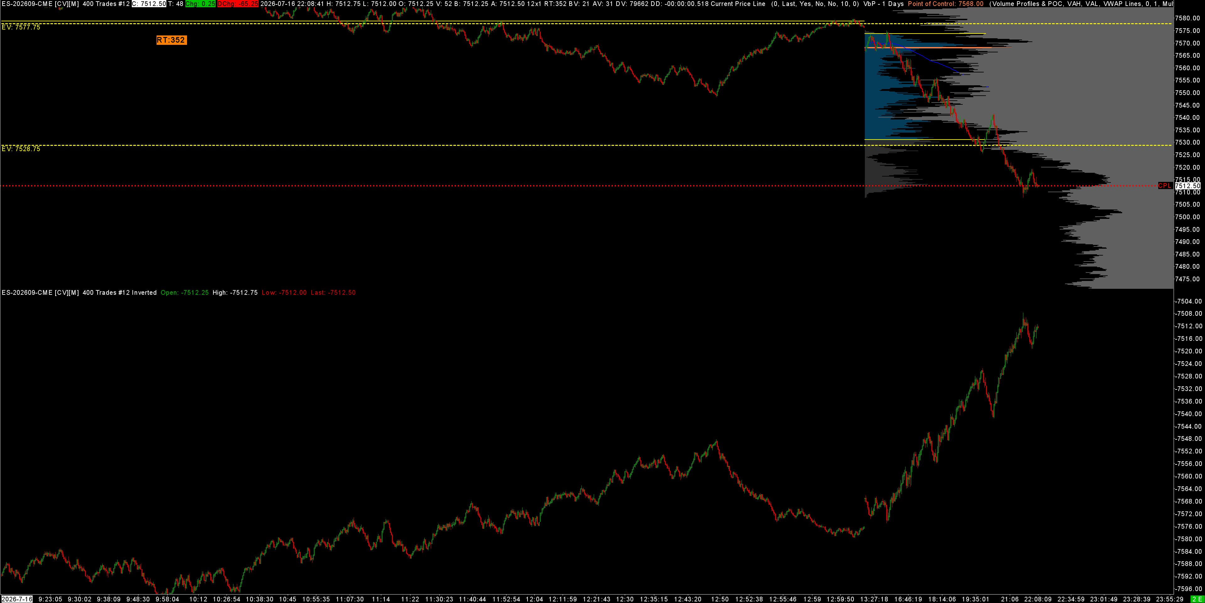

Is there a way when I use the multiply bars by -1 to also have the drawings and studies I have on the main chart reflected on the inverted chart?
https://www.sierrachart.com/image.php?Image=1784264923734.png
For example here for ES on the top I have the chart with some drawings and studies. How can I have this also reflected in the inverted chart? I tried searching for documentation on this but couldn't find anything.
imageSierraChart Inverted Graph Question.png / V - Attached On 2026-07-17 05:06:05 UTC - Size: 254.57 KB - 59 views

There is not a way to have drawings showing in that inverted region, but you could use the same concept to multiply the other studies by -1 using either the "Multiply Bars by -1" study or the "Study Subgraph Multiply" study (depending on what kind of study you are wanting to multiply), and have that result displayed in region 2.
