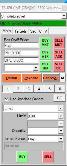

-in the Trade Window for Chart (I attached it) Sim 1 is not activated and the profit or loss is not recorded.
How do we activate Sim 1

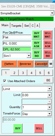

Note: when I activate "Trade simulation Mode On" below DPL: Sim 1 appears (I attached it)

imageTrade simulation Mode On.jpg / V - Attached On 2026-07-13 07:58:01 UTC - Size: 44.55 KB - 80 views
imageTrade Window for Chart.jpg / V - Attached On 2026-07-13 07:58:10 UTC - Size: 42.47 KB - 86 views

Sim1 is associated with Sierra Chart Trade Simulation Mode:
Trade Simulation
If you want to use that particular trade account, you need to enable Trade Simulation Mode.:
Trade Simulation: Using Trade Simulation
