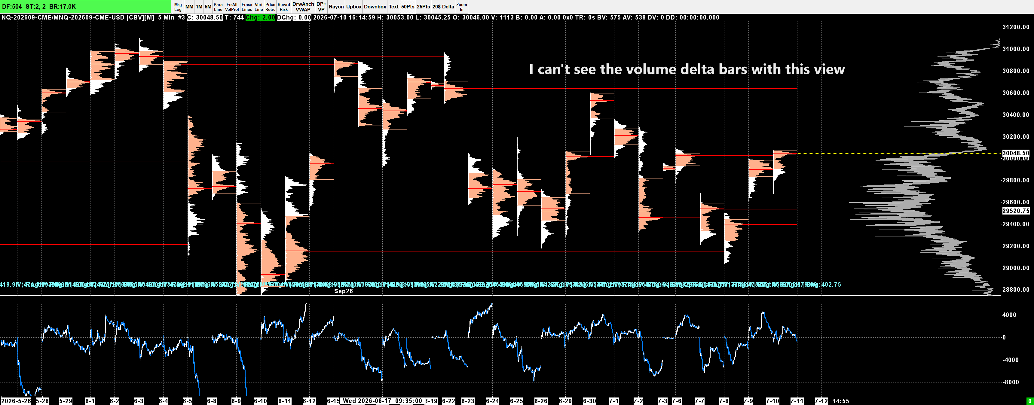

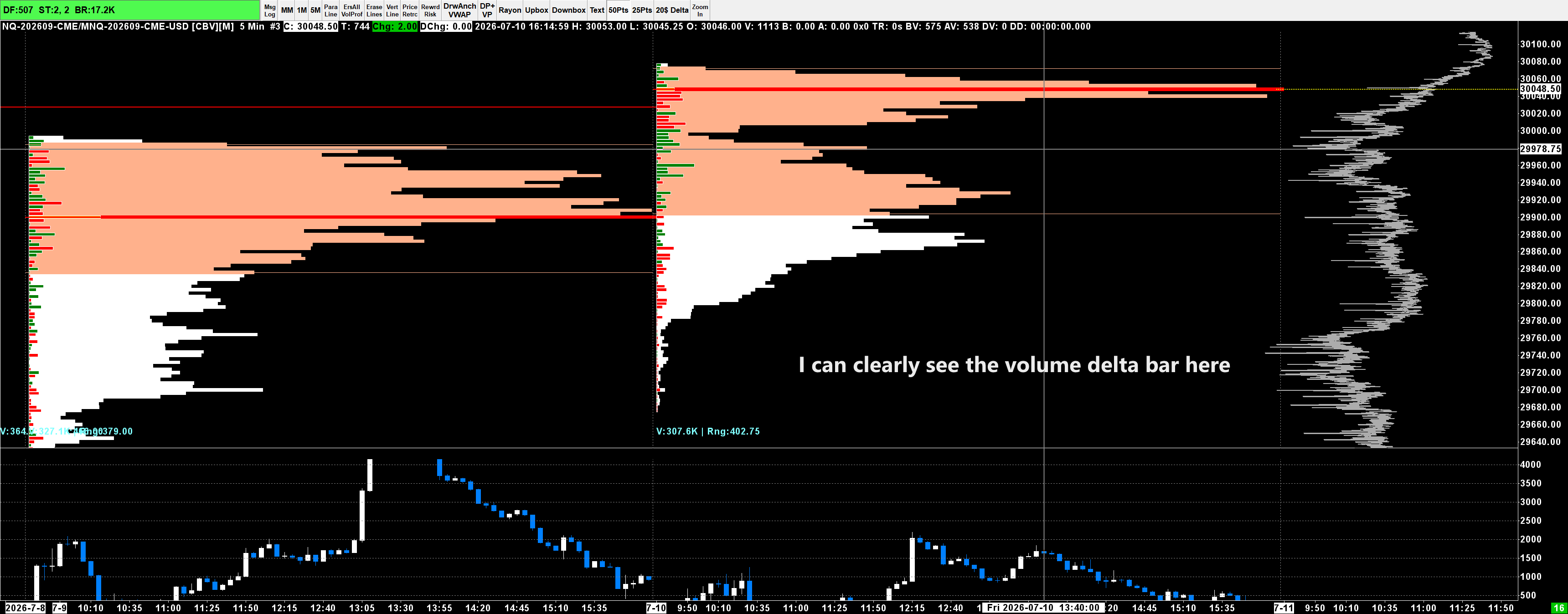

Hello!
I want to know if i can make the volume bars larger than what is displayed in the screenshot?
Screenshot 1 , i can't see the volume delta bars
Screenshot 2, i can see clearly the volume delta bars
How can i make the volume delta bar in screenshot 2 display in screenshot 1(i want bigger volume delta bars to avoid to zoom a lot in each profile)

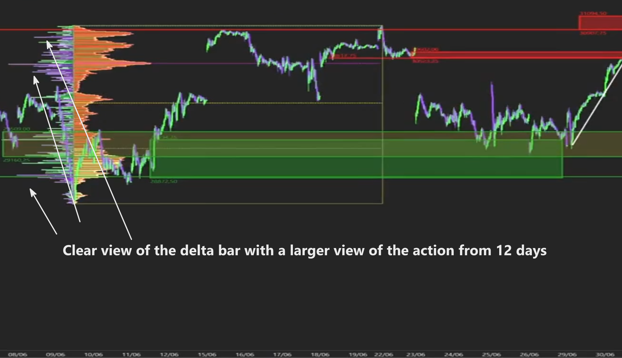

Screenshot 3 from deepchart, perfect view of the delta bars
Is it possible?
image8792.png / V - Attached On 2026-07-12 08:00:58 UTC - Size: 243.56 KB - 93 views
image8793.png / V - Attached On 2026-07-12 08:01:03 UTC - Size: 148.17 KB - 92 views

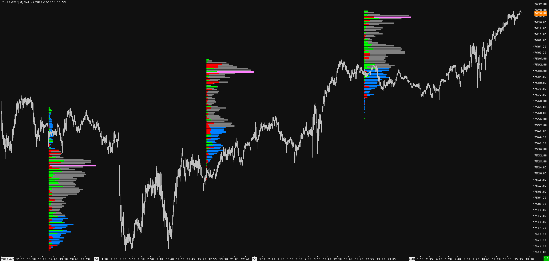

Add a second vbp for delta and adjust the profile width to suit, sample attached.
In the attached chartbook, volume profile is set to max 30% of period length, where as delta profile is set to max 10%.
The displayed size of the delta bars is no longer relative to the length of the volume bars.

imagevolume_delta_profile.png / V - Attached On 2026-07-12 17:08:29 UTC - Size: 35.76 KB - 79 views
attachmentvolume_delta_profile.Cht - Attached On 2026-07-12 17:08:43 UTC - Size: 4.7 KB - 87 views

Not currently possible, therefore I showed original poster how to achieve what they asked "bigger volume delta bars to avoid to zoom".
