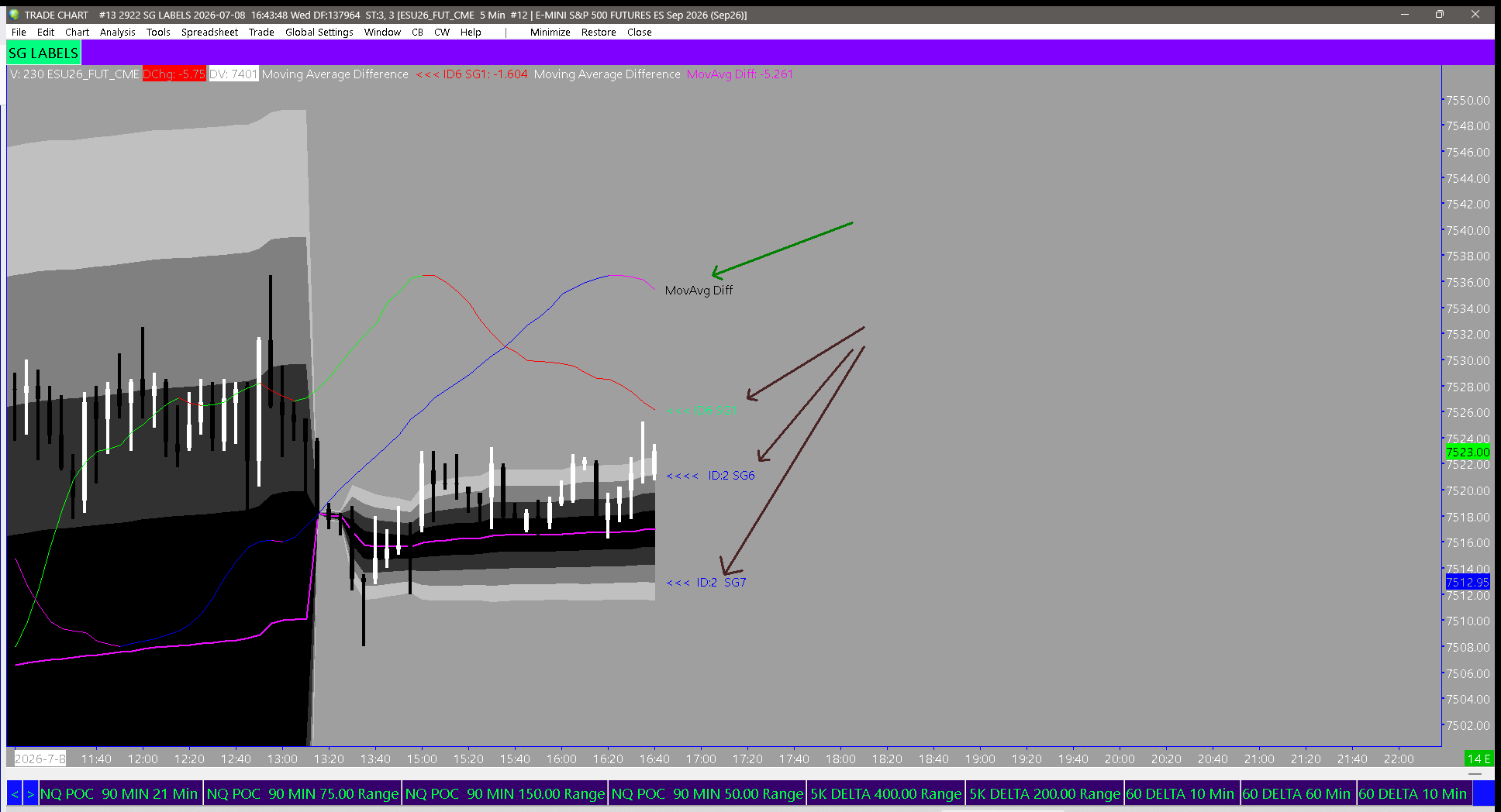

Hello support, working with a lot of studies.
Is there a quick way to toggle on/off the study name & sub-graph number so it is visible on the chart?
Been drawing them manually. Working with a lot of lines & sub graph studies.
It makes it easier to create new ideas having the study name & number visible , rather then having to memorize, back and forth between settings.
Date Time Of Last Edit: 2026-07-08 23:44:55
imagesgggggg.png / V - Attached On 2026-07-08 23:44:50 UTC - Size: 43.51 KB - 117 views
You can give each subgraph a Short Name: <<<<< ID5.SG1
Then check 'Name Label' and set Horizontal Align to 'Right'.
[2026-07-09 00:51:23]
User303857 - Posts: 199
That's exactly what I want relief from....
I was expecting the secret sawtooth sub graph study shortcut
