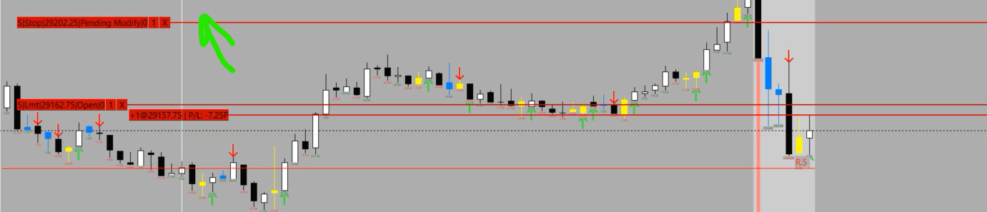

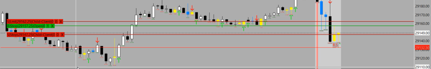

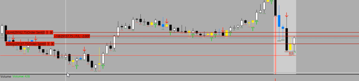

once there a signal ( yellow bar ), there's a bracket with stop, target and entry point. ( pic 1 )
and as the market is triggered at the entry level ( pic 2 )
suddenly the stop is moving to upper location ( pic 3 )

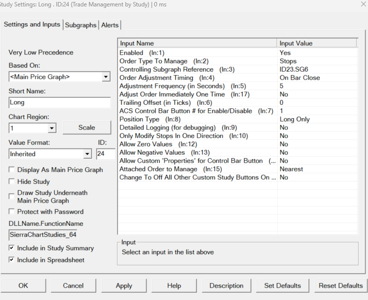

I'm using 2 "Trade Management by Study"
one is for stop in Long positions
and the other one is for stop in Short Positions
attached is the stop for long settings.
if I will do the stop management using the spreadsheet will be better ?
imageTrade Managment by Study - Long Setting .png / V - Attached On 2026-07-22 14:34:35 UTC - Size: 179.03 KB - 40 views
[2026-07-22 16:31:21]
John - SC Support - Posts: 48143
The Spreadsheet Study can not move a Stop or Target. It only allows you to set the initial position.
The "Trade Management by Study" is used to move Stops or Targets after the trade is in place.
We can not say what may be incorrect about your Trade Management by Study. That is something you need to look into and figure out.

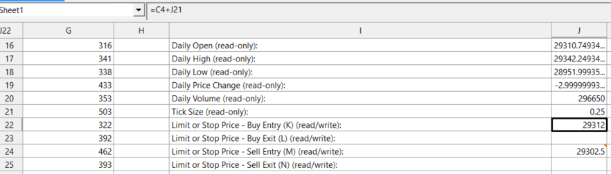

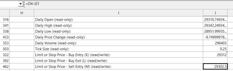

Is it possible that I see that there are also values in cells 22 and 24 ( see attached pictures ),
and that interrupts the trade management study ?
do I need to erase them?
imageJ22 CELL.png / V - Attached On 2026-07-22 16:43:25 UTC - Size: 74.2 KB - 41 views
imageJ24 CELL.png / V - Attached On 2026-07-22 16:43:32 UTC - Size: 60.55 KB - 58 views
[2026-07-22 17:19:28]
Those are the prices at which a primary Limit or Stop order will be placed from the Spreadsheet System for Trading. Refer to the following:
Spreadsheet Systems, Alerts and Automated Trading: Limit or Stop Prices (read/write) [[v1:J22,v2:J78], [v1:J23,v2:J79], [v1:J24,v2:J80], [v1:J25,v2:J81]
Those are NOT the attached orders prices. And, as we stated, the Spreadsheet System for Trading does not have any control over the attached orders once an order has been entered.

so what can be the cause for making the stop suddenly change his position up for no reason ( see attached photos )
image1. before entring the trade .png / V - Attached On 2026-07-22 17:23:58 UTC - Size: 135.76 KB - 67 views
image2. the trade enterd .png / V - Attached On 2026-07-22 17:24:05 UTC - Size: 126.21 KB - 64 views
image3. the stop moves .png / V - Attached On 2026-07-22 17:24:14 UTC - Size: 132.33 KB - 55 views
[2026-07-22 18:34:31]
It is your Trade Management by Study. You need to look at what it is doing, and make sure that you are actually activating the correct one.
