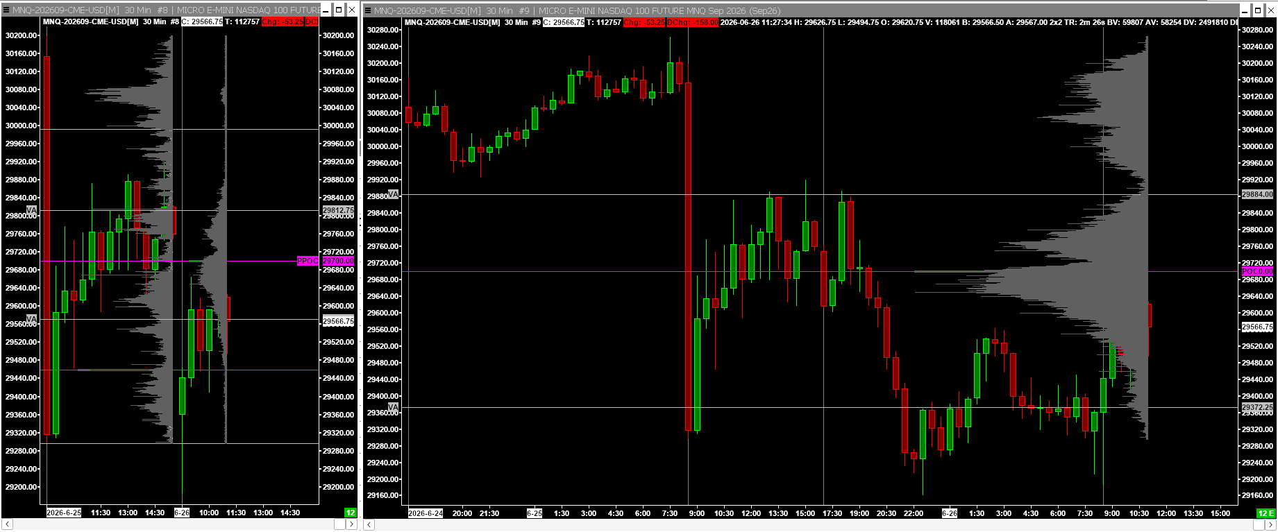

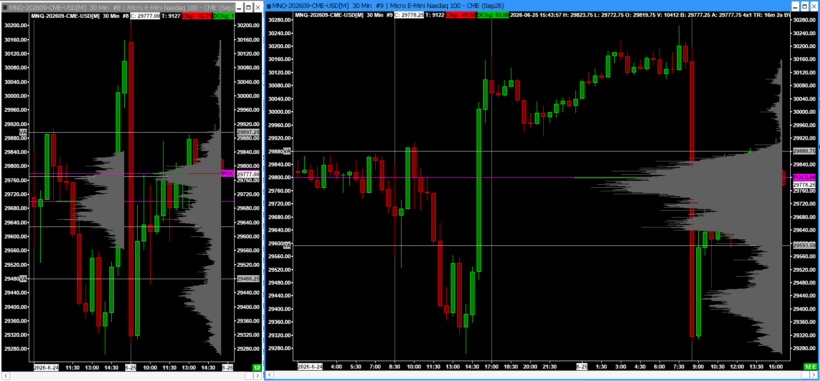

[2026-06-25 20:48:00]
User512353 - Posts: 190
screenshot
imageScreenshot From 2026-06-25 20-44-23.png / V - Attached On 2026-06-25 20:47:54 UTC - Size: 71.81 KB - 73 views

[2026-06-26 16:30:39]
Sorry, need to reopen this.
The previous post, that "Use Different Start Time = No" would solve it, was wrong. That was an artifact, because the session had ended.
So, for case 2, regardless of the setting of "Use Different Start Time", it will draw the current day's profile, while in case 1 it doesn't.
It is unclear why this occur.
imageScreenshot From 2026-06-26 16-27-45.png / V - Attached On 2026-06-26 16:30:34 UTC - Size: 72.53 KB - 64 views
