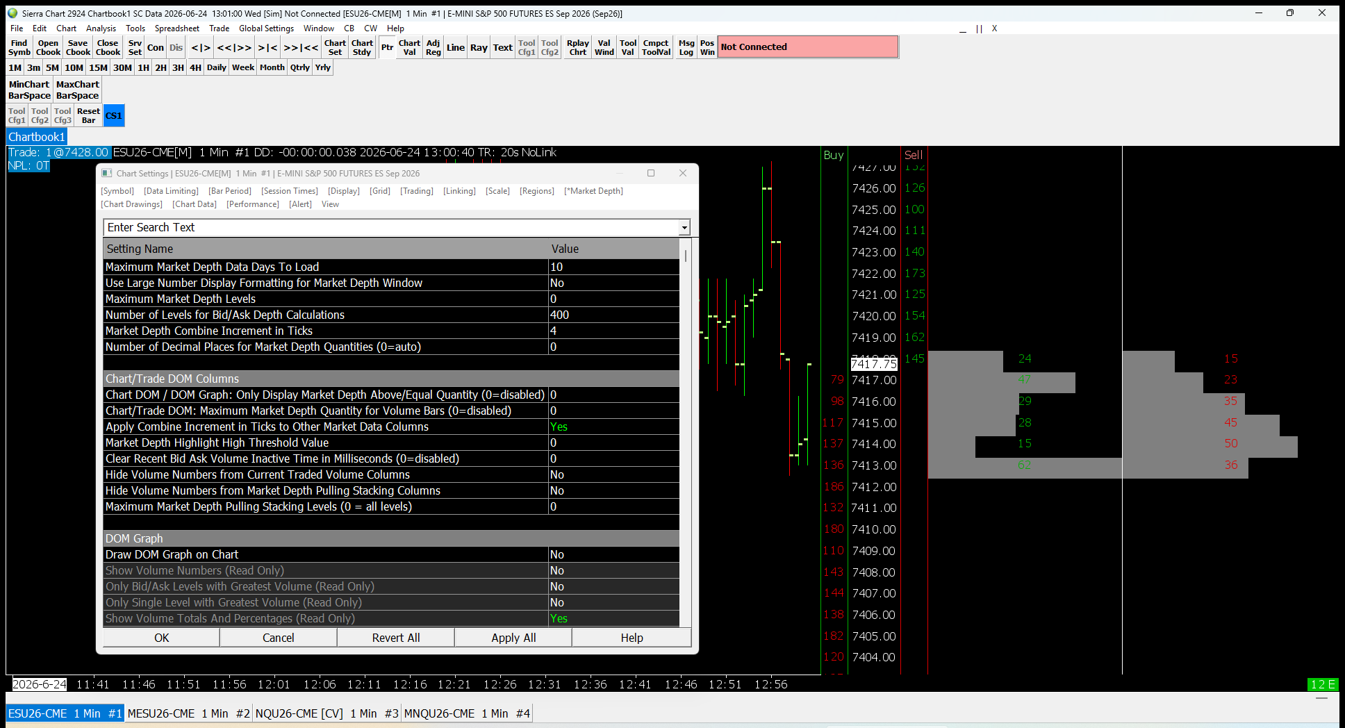

in V2923/2924, the parameter Recent/Current Volume Bars Length Relative to Bid and Ask has no effect at all when Apply Combine Increment in Ticks to Other Market Data Columns is activated.

[2026-06-24 18:08:10]
John - SC Support - Posts: 48013
We are not seeing an issue with this in version 2924. Attached is an image showing our Chart Settings that has the "Combine Increment in Ticks" set to "4" and the "Apply Combine Increment in Ticks to other Market Data Columns" set to "Yes".
The "Recent Bid Volume" column is the one to the far right and the "Recent Ask Volume" column is the one directly to the left of the "Recent Bid Volume". The "Maximum Volume Bar Width Percentage" is set to 100. For this image, the "Recent/Current Volume Bars Length Relative to Bid and Ask" is set to "Yes".
When the option for "Recent/Current Volume Bars Length Relative to Bid and Ask" is set to "No", each column has single volume bar that extends all the way to the end of the column. In the image, you will see that the largest volume between the two columns is the 65 in the Recent Ask which has the volume bar fully across the column, and in the Bid column the highest value is 50, which has the volume bar not extended fully across the column.
If you are continuing to have this issue in 2924, then please get us an image like the one we provided. Please ensure you do not have a lot of data in the columns, as it becomes very difficult to determine what is occurring if there is too much information. Refer to the following for how to get us an image:
imageSierra_Chart_MainWindow_2026-06-24 13_00_58.167.png / V - Attached On 2026-06-24 18:06:49 UTC - Size: 140.11 KB - 127 views

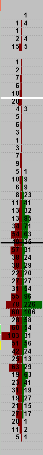

I noticed the bug on the Current Traded Bid Volume and Current Traded Ask Volume columns.
I didn't notice the bug on the Recent Bid/Ask Volume columns as I don't use volume bar for these columns.
Here is a screenshot of NQ Current Bid/Ask Volume columns, with combined 4T activated, and Recent/Current Volume Bars Length Relative to Bid and Ask: Yes.
You can see the 103 BID and 226 ASK have the same bar size.
Maximum Volume Bar Width Percentage: 98, not 100, but it should not have any impact.
imageScreenshot 2026-06-24 192633.png / V - Attached On 2026-06-24 18:12:47 UTC - Size: 29.11 KB - 108 views
[2026-06-24 18:28:12]
We are able to reproduce this with the "Current Bid/Ask Volume" columns. We will pass this along to Engineering to take a look.
[2026-06-25 01:27:18]
Sierra_Chart Engineering - Posts: 24971
This will be resolved in the next release.
