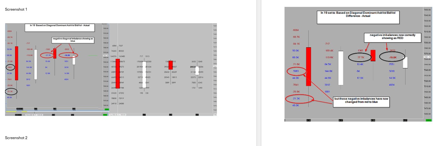

Hi - I run the number bars study in order to see diagonal imbalances on charts across a number of different timeframes.
My settings are
ln 16 Number Bars Text - Ask Vol Bid Vol Diff Diagonal Bid Side
ln 19 Text Coloring Method - Based on Diagonal Dominant AskVol BidVol - Actual
In most lines, the diagonal imbalance colors correctly - blue for positive / red for negative imbalance.
In a couple of situations however, the negative imbalance actually colors as blue.
I need the correct coloring in order to spot negative imbalance quickly.
How do I get all positive imbalances to color blue and all negative imbalances to color as red.
I have tried setting ln 19 Text Coloring Method to "Based on Diagonal Dominant AskVol BidVol Difference - Actual" - this fixes some of the incorrect imbalance colors, but then changes other negative imbalances that were showing correctly as RED to now show as BLUE

imagemidas59 number bars coloring issue 22 June.jpg / V - Attached On 2026-06-22 13:07:38 UTC - Size: 78.3 KB - 92 views

There is not a Background/Text Coloring option that does exactly what you are wanting (Color Bid Side Diagonal Difference based on Positive/Negative).
Also, the options you are choosing are not incorrect, they are just not doing what you are expecting. You need to keep in mind that with Diagonal Differences, you can have one of 3 different results:
- Neither side dominant
- Bid Side Dominant
- Ask Side Dominant
When you are displaying just the Bid Side, this is not reflecting the dominant side in the diagonal differences - it just gives a one-sided view.
