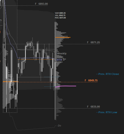

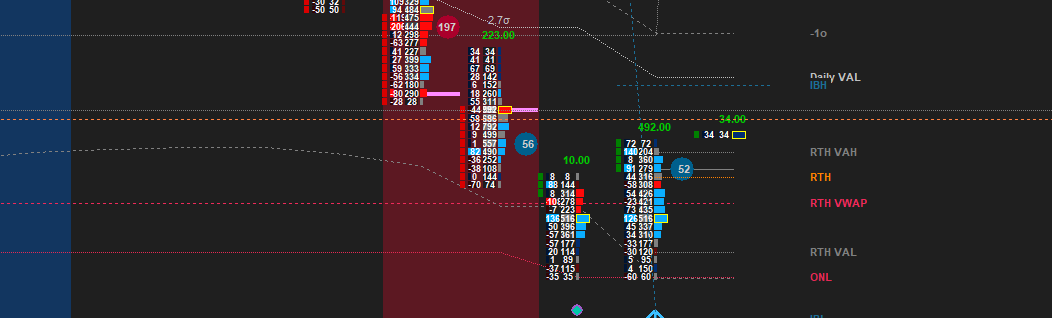

Hello I am using standard replay to back test. My execution chart is 16 tick standard range bars, and I have several other high time frame charts like m30, h2, daily. When using the to next bar jump method I notice it skips to next bar on all charts. I am wondering if I can make it so it only skips to next bar on my execution chart and my htf charts follow accurately.
I attached my execution chart as well as my m30 chart to show how the m30 skips a whole bar when I just want it to follow where price is at on my execution chart.
image16 tick chart.png / V - Attached On 2026-06-20 19:07:27 UTC - Size: 35.39 KB - 109 views
imagem30 chart.png / V - Attached On 2026-06-20 19:07:32 UTC - Size: 18.08 KB - 110 views
