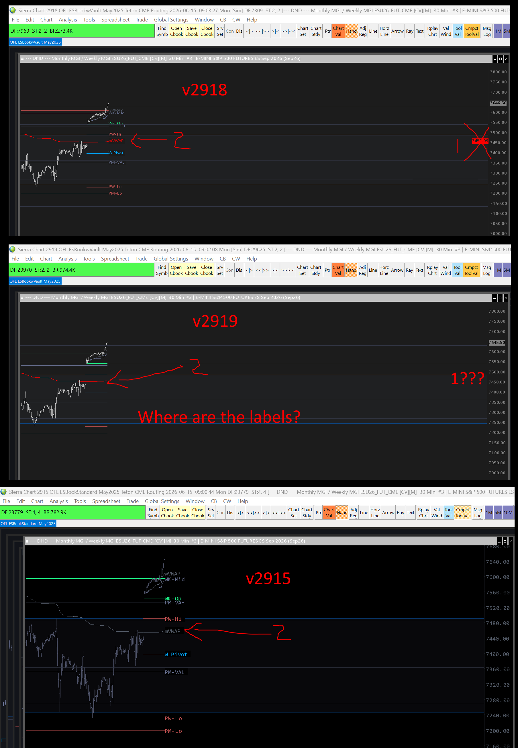

There is a regression in v2919 that is not present in v2915 nor v2918.
See attached image.

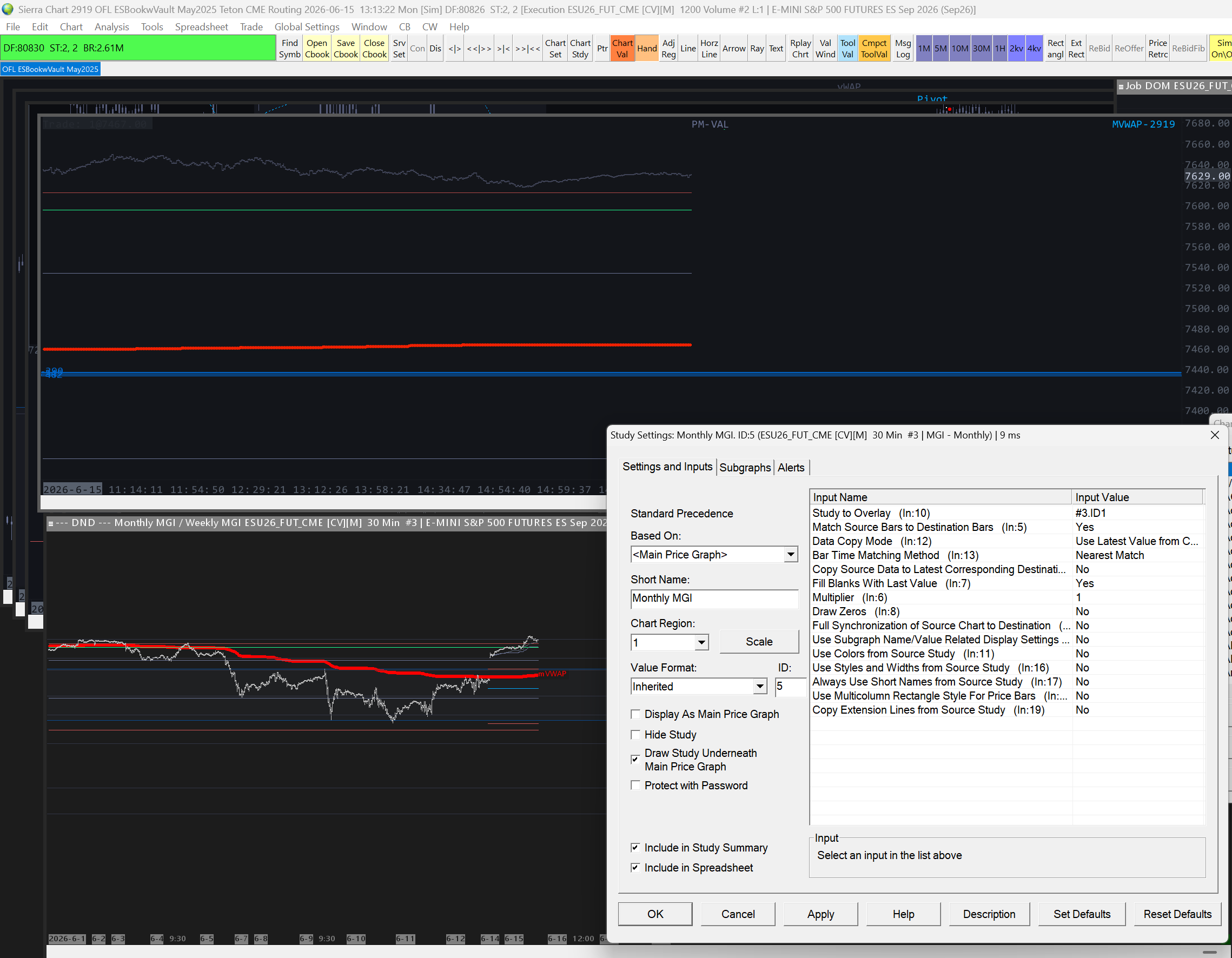

Also, with Study Price overlay onto another chart, the Labels show up at the top of the chart and do not seem correlated with price.
imageSierra v2919 label regression.png / V - Attached On 2026-06-15 16:12:50 UTC - Size: 254.33 KB - 109 views

With the issue of the "Study/Price Overlay" you state, are you overlaying the same study in which you are having the issue with the labels? If not, then what study are you trying to overlay? Please get us an image of that chart by following these instructions:

This is from a custom study targeted for v2915 (using sierrachart.h that requires v2911+) that finds various levels like prev open, running vwap. Basically, writes out several Subgraphs.
As you can see, the exact same chartbook works on 2915/2918 and breaks on 2919.

For the overlay, it's overlaying that same study in the attached image. The root of the problem starts with the chart attached.

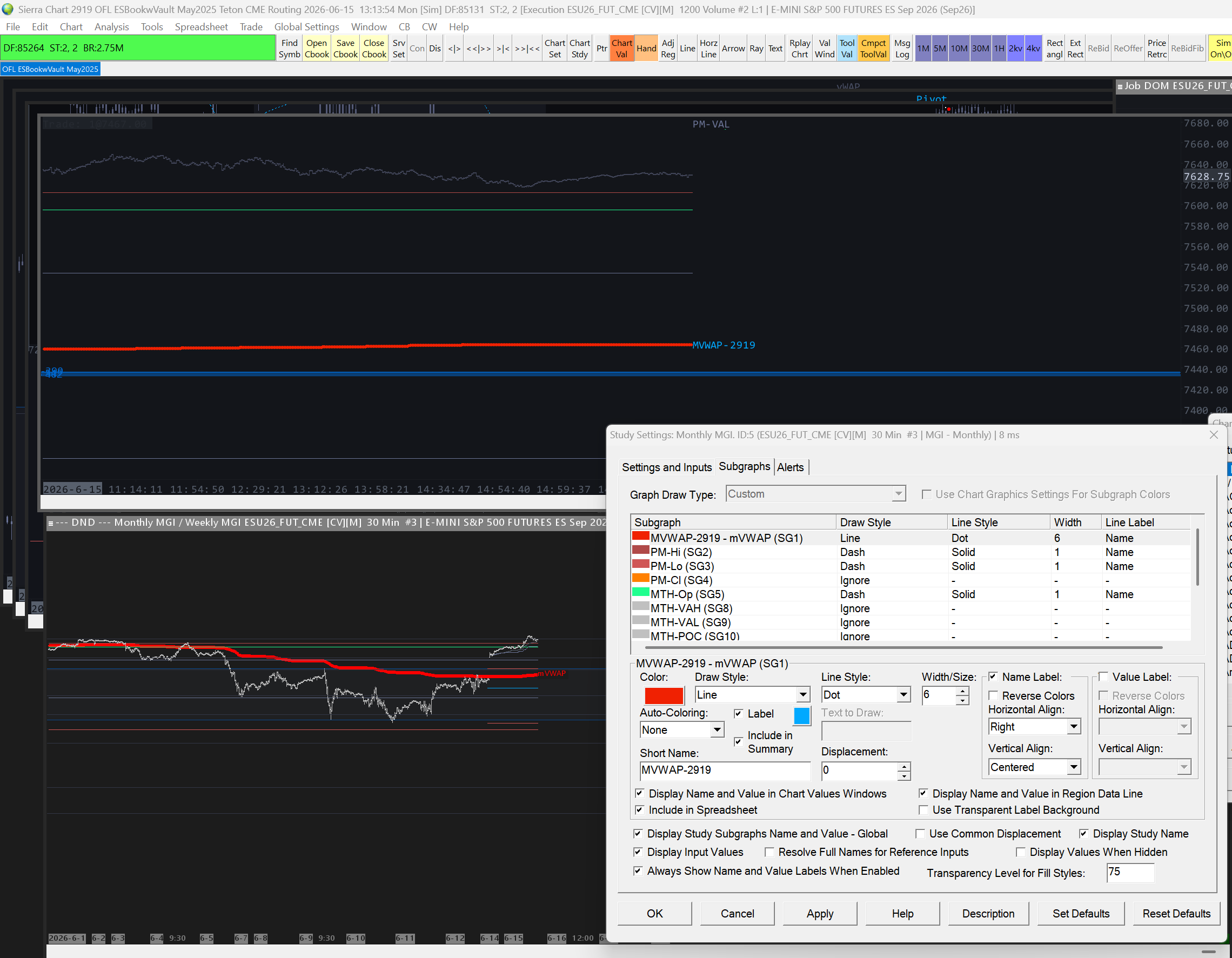

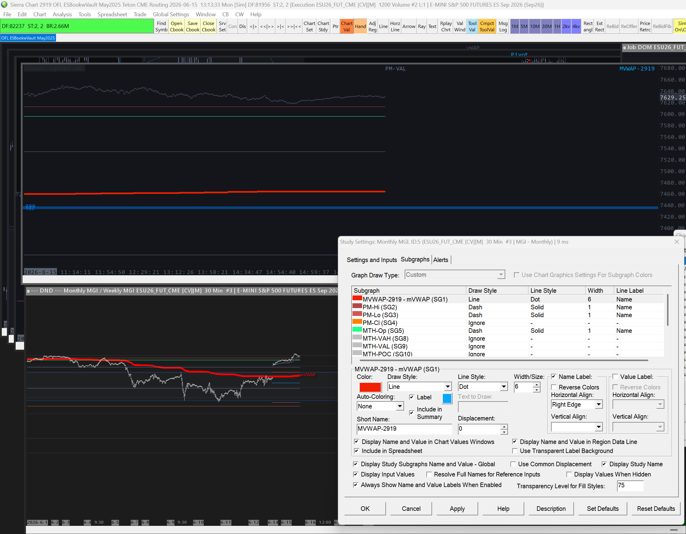

I have more info on this. Attached is the Study Price Overlay (and same happens on source chart).
The Vertical Alignment is blank.
On <2918 labels display as expected.
On 2919, labels do not display correctly and show at top of chart and not at price level.
Setting Vertical Alignment in 2919 causes the label to show, and at correct price.
imagelabel upper right.png / V - Attached On 2026-06-15 20:19:47 UTC - Size: 241.28 KB - 91 views
imagevertical alignment is blank.png / V - Attached On 2026-06-15 20:19:52 UTC - Size: 240.2 KB - 94 views
imagevertical alignment set.png / V - Attached On 2026-06-15 20:20:00 UTC - Size: 243.03 KB - 91 views
