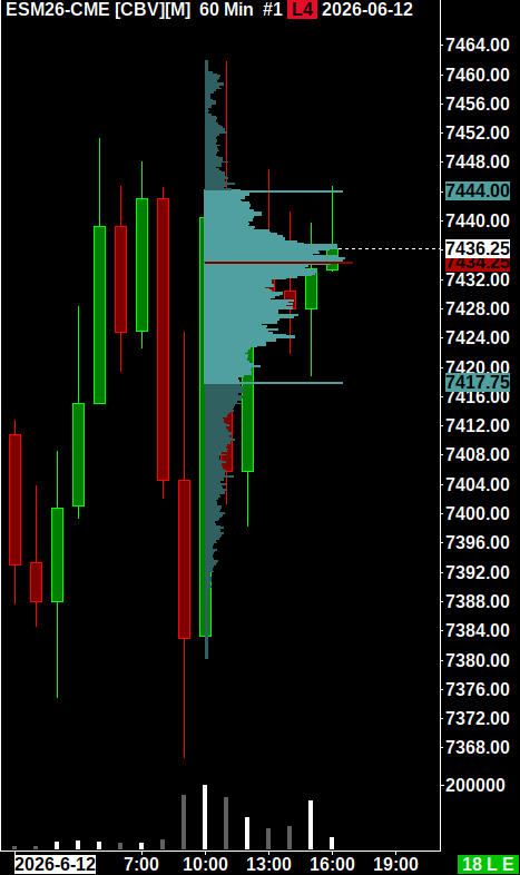

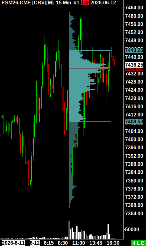

I noticed that values of VAH, VAL depend whether I'm using 1h or 15m chart.
For instance, for last Friday 12-Jun the values are as follows:
1h chart:
https://www.sierrachart.com/image.php?Image=1781341161639.png
* VAH: 7444,00
* POC: 7434,25
* VAL: 7417,75
15m chart:
https://www.sierrachart.com/image.php?Image=1781341213269.png
* VAH: 7443,25
* POC: 7434,25
* VAL: 7408,50
Why there are such differences depending on selected timeframe ?

Why there are such differences depending on selected timeframe?
Look at the pictures you uploaded, the profiles don't contain the same data.
The 15-minute VBP starts at 09:30 and the 60-minute starts 10:00.
When you set the time in the VBP it includes the entire bar that contains the start time or end time, it does not divide the bars up.
