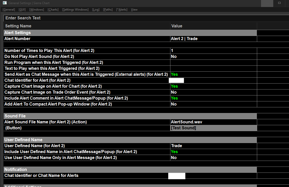

So it's probably not an issue with ntfy, if the Chat is not getting the link.
Check your Alert setup for the alert number in which the information is being sent to the chat. Make sure the option for "Capture Chart Image on Alert for Chart" is set to "Yes" for that particular alert.
