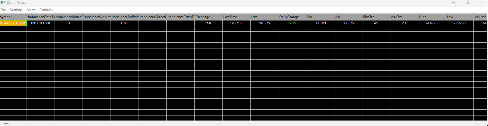

Hello Sierra Chart Support,
I am trying to access auction imbalance data (Opening Cross / Closing Cross) through both the Quote Board and ACSIL.
Environment:
* Sierra Chart - Version 2913 64 bit.
* Denali Data Feed
* Nasdaq TotalView (NQTV symbols)
* Teton Order Routing
ACSIL functions being used:
s_SCBasicSymbolData Data;
sc.GetBasicSymbolData(Symbol, Data, true);
auto& Imb = Data.m_ImbalanceData;
I am reading the following fields:
Imb.DateTimeUTC
Imb.MatchingQuantity
Imb.NonMatchingQuantity
Imb.CurrentReferencePrice
Imb.ImbalanceDirection
Imb.CrossType
According to the ACSIL documentation and SCSymbolData.h, these fields appear to support imbalance data.
To verify the data independently, I also created a Quote Board and added the following columns:
* ImbalanceDateTime
* ImbalanceMatchQty
* ImbalanceNoMatchQty
* ImbalanceRefPrice
* ImbalanceDirection
* ImbalanceCrossType
I tested both methods and found that all imbalance-related fields remain blank or zero.
Questions:
1. With Denali + Nasdaq TotalView, should the imbalance fields in Quote Board populate for symbols such as:
* AAPL-NQTV
* QQQ-NQTV
* SPY-NQTV
* JPM-NQTV
during the Nasdaq Opening Cross and Closing Cross periods?
2. Should s_SCBasicSymbolData::m_ImbalanceData be populated through sc.GetBasicSymbolData() for those symbols?
3. Is any additional market data entitlement or exchange service required to receive NOII / auction imbalance data?
4. If these fields are not supported through Denali/NQTV, what is the recommended method to access Nasdaq opening and closing auction imbalance information from ACSIL?
Thank you for your help.
Regards,
Ram Kumar
imagequote board.png / V - Attached On 2026-06-08 20:03:52 UTC - Size: 83.33 KB - 166 views
[2026-06-10 18:44:00]
Sierra_Chart Engineering - Posts: 25390
We are not sure about this. We have to see if that data shows up in the morning only.
We do see a timestamp right before the 9:30 AM open for these fields.
Although we do see the imbalance Direction and Cross type and they are both the letter O for SPY-NQTV.
[2026-06-12 23:20:45]
ramsoft2003 - Posts: 13
Thanks.
FYI - I have been watching this since i created this ticket and i don't see any NOII data both morning and evening in the quote board as well as through the function calls. So am not getting NOII data even though i have valid data subscription with a non professional trading account.
[2026-06-16 01:35:13]
We looked into this, and we cannot identify any problem. The imbalance data from NASDAQ TotalView is definitely being processed. Some of the fields are clearly set. For the fields that are zero, we do not know why.
