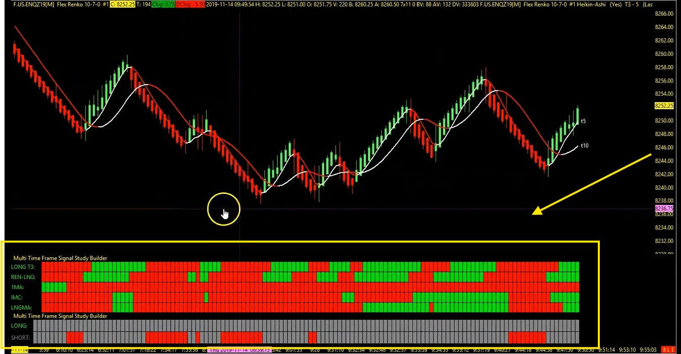

What is the documentation to be able to replicate this table style chart region?
View Count: 269
[2026-06-01 20:17:05]
jethrogou - Posts: 56
Good day,
I have been trying to figure out what documentation is needed to be able to replicate this table-like chart study for ACSIL.
imageScreenshot 2026-06-02 041225.png / V - Attached On 2026-06-01 20:16:14 UTC - Size: 665.64 KB - 111 views
[2026-06-02 13:00:10]
There is the following documentation for ACSIL for the Numeric Information Table:
ACSIL Interface Members - sc.Subgraph Array: Numeric Information Table Graph Draw Type
But given that there are no numbers displayed, we wonder if they created their own table of some kind.
Also, for what it is worth, there is a "Numeric Information Reference" study that allows you to display values for any study. Refer to the following:

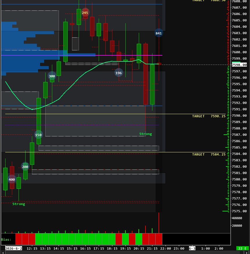

Thank you! Figured it out a while ago, will also look into the numeric information reference for future studies. Took me a while to get used to Sierra chart's platform. Always appreciate the support, thank you again!
imageScreenshot 2026-06-02 214025.png / V - Attached On 2026-06-02 13:42:59 UTC - Size: 52.95 KB - 125 views
