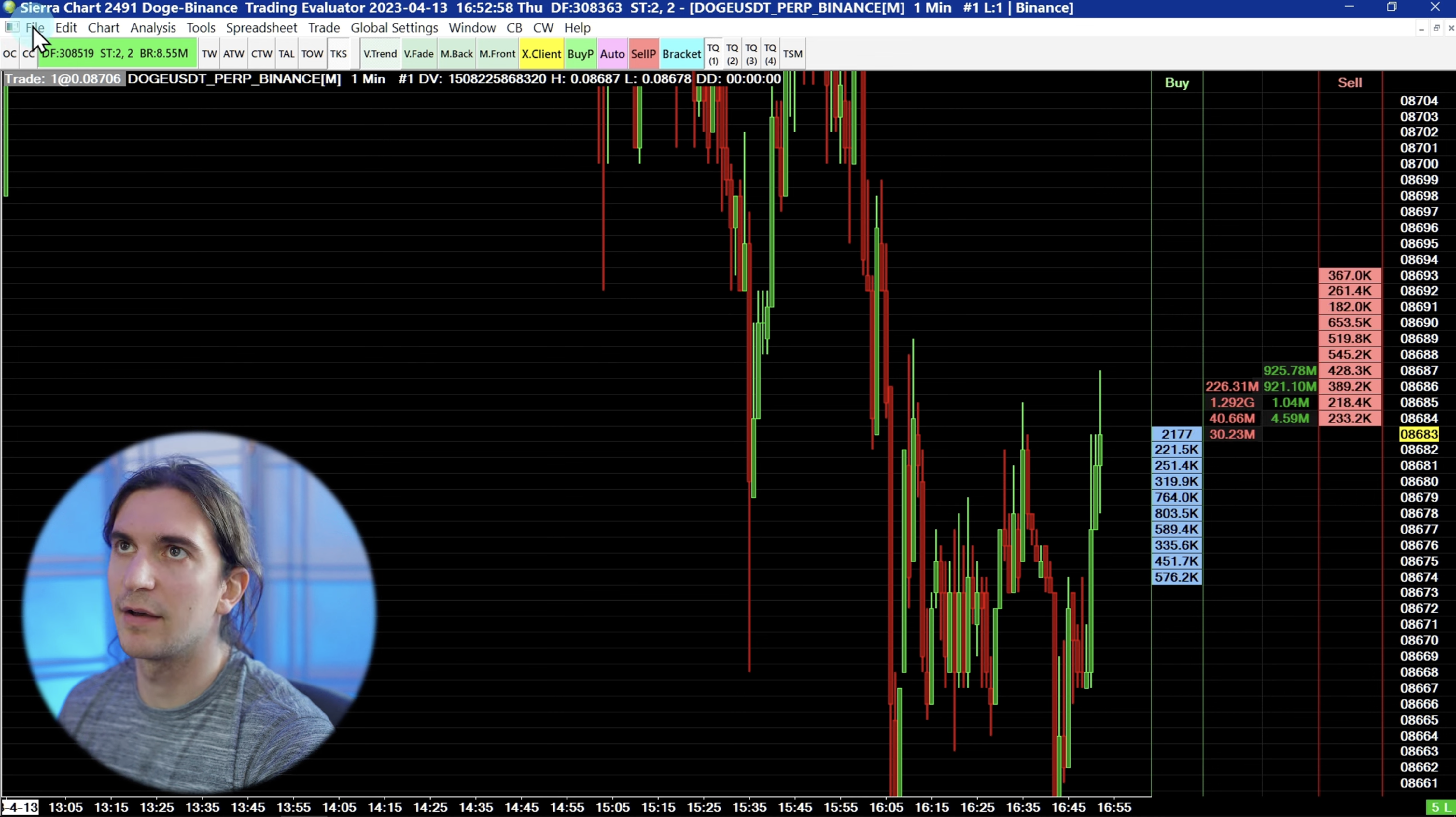

Hi there,
I have read Cryptocurrency / Bitcoin Data and Trading Services and am aware that market depth is "Not provided for Binance symbols". Currently I can only see the Level 1 on the bid side and ask side for any Binance symbol. I just watched a YouTube Video of VerilloTrading though (https://www.youtube.com/watch?v=Gldk81rWZ5U) and there it seemed as if he had DOM data for DOGEUSDT_PERP_BINANCE (image attached). Is it somehow possible to unlock DOM (Level 2) data for Binance symbols? I saw that you provide this kind of data for Bitfinex symbols and wondered why since the volume on the exchange is much lower than on Binance. It would make much more sense to support market depth data on Binance symbols.
If it is not possible to unlock the data, would it be possible for me to get the market depth data through the Binance API and integrate it myself into Sierra Chart? Do you have any customers who did that already?
imageVerillo Trading; Binance Market Depth.png / V - Attached On 2026-05-31 12:10:13 UTC - Size: 4.19 MB - 132 views
[2026-05-31 21:01:13]
Sierra_Chart Engineering - Posts: 25390
No, we removed market depth data for Binance because it is too much data to process and support:
Yes this is possible but you have to develop a DTC Protocol compatible server and provide Sierra Chart, the bid and ask, Trade and market depth data completely. Not just market depth data. And then you can use the DTC client in Sierra Chart to connect to your server:
